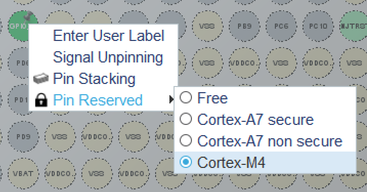

Hello all,
I am used to the regular MCUs STM32Fx families where I'm used that the main.h has all the #defines of the GPIOs and other peripherals.
I'm now using STM32MP1 generating code for CM4 and noticed it is generate any #define information.
also, it is not initializing GPIOs state.
Why is it generating no initialization of GPIOs or other user label #defines?

‎2022-03-29 9:33 AM
GPIO pin context is assigned at the pin level.
Right click the pin in pinout view -> Pin Reservation -> Cortex M4

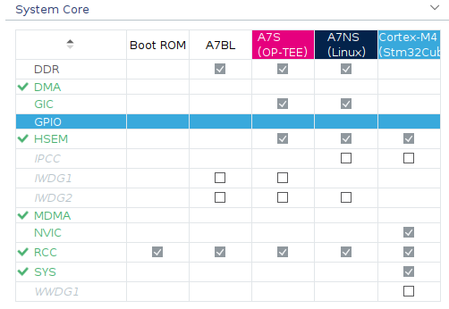

Are they assigned to the CM4 core? Attach your IOC.
‎2022-03-29 9:22 AM
‎2022-03-29 9:24 AM
It gives me no option to select the target for GPIOs:

‎2022-03-29 10:04 AM
Thanks, that was a new (hidden) option for me!
