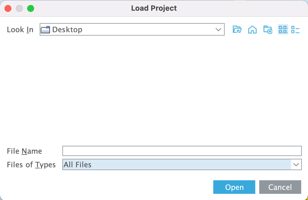

currently I can't open any .ioc file which hasn't been previously created with my computer.
There's no problem if I open an .ioc file inside CubeIDE, but, when I want to use VS Code I need to open the .ioc file using just CubeMX.
If I open an .ioc file with CubeMX, the program brings me the startup page. Whether I try to load a project directly from CubeMX, I can't navigate through the folders because, even in the Desktop folder the file navigator shows me an empty space.
Does anyone have my same problem, with MacOS?

Hi @f4_kiddo​,
Can you follow the solution described in this post ?
STM32CubeMX 6.4.0 doesn't interact nicely with MacOS 12.1 (Monterey)
Let me know the result.

Thank you so much!
Now it's working fine :beaming_face_with_smiling_eyes:
RMora.4
I was having the same problem and this solution worked for me. Thank you.
Although I will say that this shouldn't be an issue that we should be struggling with. I don't remember this being an issue when I installed an earlier version of CubeMX.
