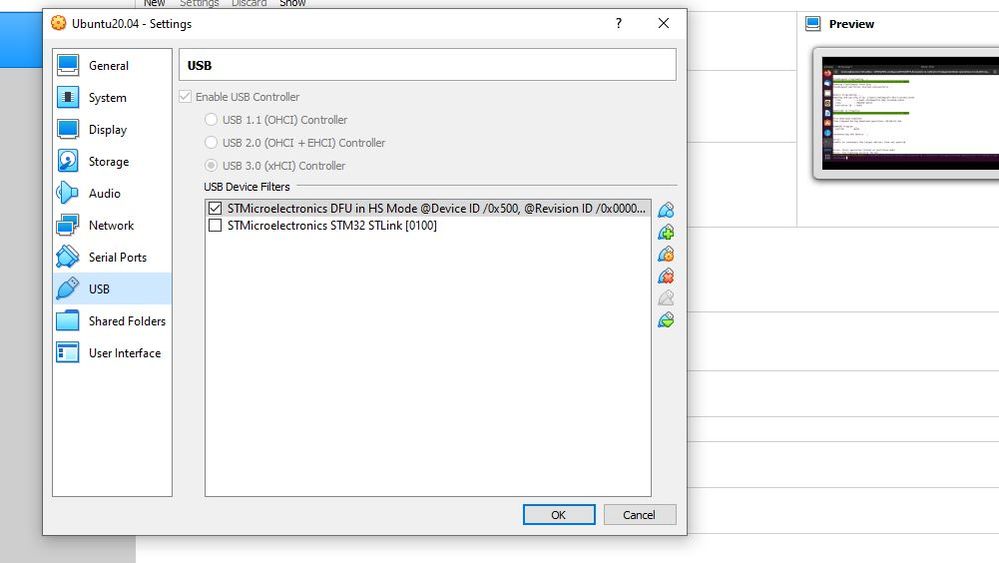

PatrickF
Hi @MVENN.1​
that's sound very like a VM configuration issue, it is described in the FAQ link we already provided to you (https://community.st.com/s/article/FAQ-STM32MP1-STM32CubeProgrammer-USB-reconnect-error-at-STM32MP1-boot-device-flashing).
Abstact:"
  • If you are using a VM, check the USB 'connection' between Linux and Windows as uBoot reconnect using a different USB identification and might not be 'routed' to the VM.
  • In VMWare, you have a menu Player/Removable Devices where you can choose which devices that belong to Virtual Machine or to Windows. In VirtualBox it should have similar setting.
When uBoot start up, check at that time in your VM if you have 'USB download gadget@Device ID /0x500, @Revision ID /0x0000)' as a new removable device to 'connect' to your Virtual Machine.
Regards.

MVENN.1
Hi PatrickF ( ST Employee )
Thanks for your reply.
Its working everything really thanks for your support.
after adding VM in 'USB download gadget@Device ID /0x500, @Revision ID /0x0000)'  and select in VM.
