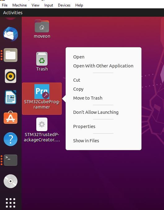

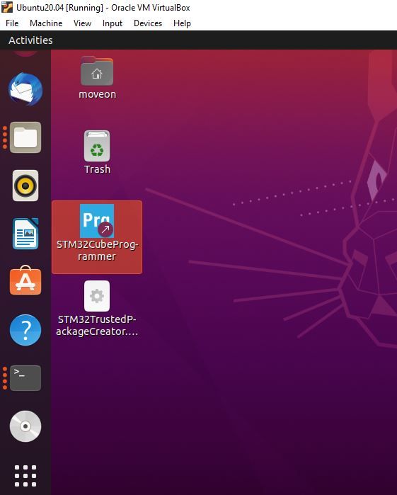

HI Olivier GALLIEN (ST Employee)
I am using Ubuntu 20.04 version.
on the desktop icon is there but it doesn't open when i am click to "Allow Launching"
it shows like
0693W000005CNwMQAW.jpg0693W000005CNwCQAW.jpgThanks

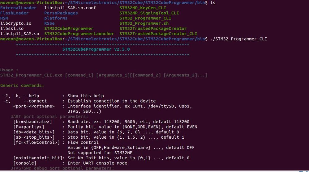

Hi @MVENN.1​ ,
First of all, did you do all these prerequisites:
PC $> sudo apt-get install openjdk-8-jre-headless
PC $> sudo update-alternatives --config java
Select the java-8-openjdk configuration.
PC $> sudo apt purge openjfx
PC $> sudo apt install openjfx=8u161-b12-1ubuntu2 libopenjfx-jni=8u161-b12-1ubuntu2 libopenjfx-java=8u161-b12-1ubuntu2
PC $> sudo apt-mark hold openjfx libopenjfx-jni libopenjfx-java
Then, did you well choose "$HOME/STM32MPU_workspace/STM32MPU-Tools/STM32CubeProgrammer-2.5.0" as path when installing the launcher ? And is it working when running "$HOME/STM32MPU_workspace/STM32MPU-Tools/STM32CubeProgrammer-2.5.0/./STM32CubeProgrammer" ?
Also, does the CLI is working ? (what do you get when running "$HOME/STM32MPU_workspace/STM32MPU-Tools/STM32CubeProgrammer-2.5.0/./STM32_Programmer_CLI")
Armand
this information i am getting please check it.
0693W000005CORjQAO.jpgThanks
