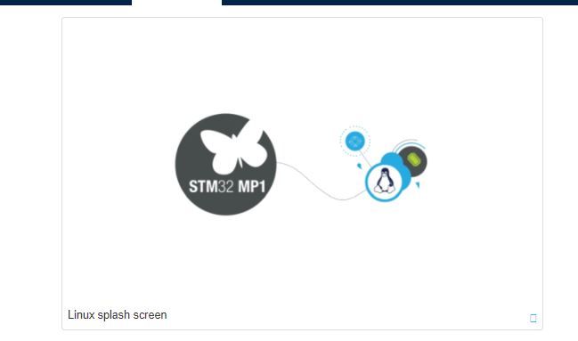

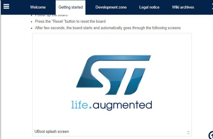

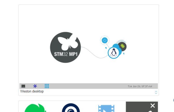

‎2020-11-25 3:01 AM
Hi
Thank you for given this information.
I can able to flash the image on SD card in STM32CubeProgrammer in Windows.
After Booting( ON position ) i am getting default images like
After that this image only showing last 10 min onwards
i am not getting this image down one .
any one can reply.
