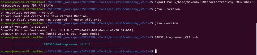

How to launch STM32Cubeprogrammer in ubuntu can you please tell me.
MVENN.1
i am not able to flash the image in stm32mp157c-dk2

Olivier GALLIEN
The installation PATH of STM32CubeProgrammer is not the good one as expected.
You have to install in "$HOME/STM32MPU_workspace/STM32MPU-Tools/STM32CubeProgrammer-2.5.0/" and add the binary path to path environment variable "export PATH=$HOME/STM32MPU_workspace/STM32MPU-Tools/STM32CubeProgrammer-2.5.0/bin:$PATH"​

MVENN.1
Hi Olivier GALLIEN (ST Employee )
Thank you for reply.
I am just installer STM32Cubeprogrammer 2.5.0 version in Ubuntu 20.04
can you please give steps to install the 2.6 version.
Thanks
please once check it. actually i installed everything but i did small mistake i don't know.
0693W000005CP0UQAW.jpg Thanks

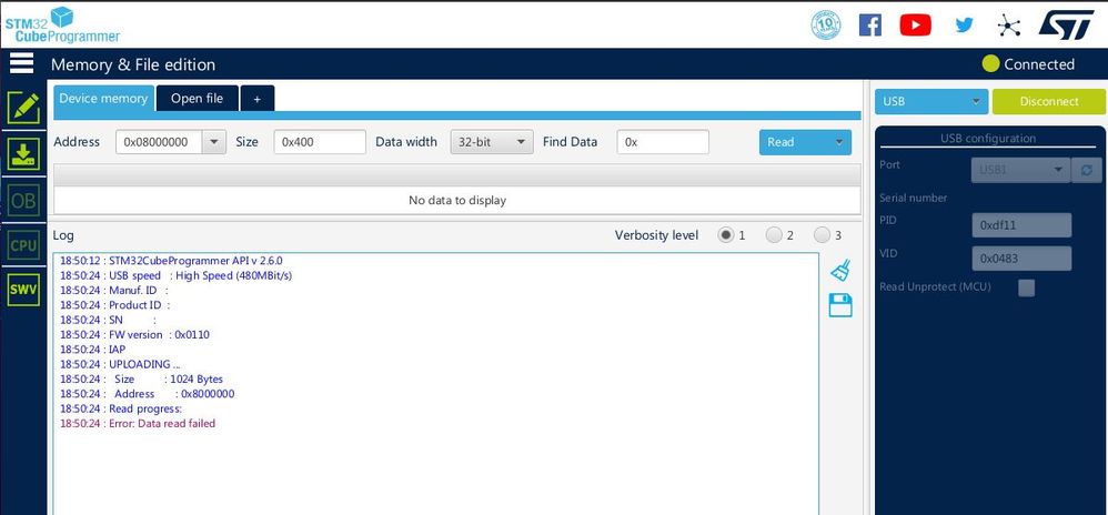

when I launch and connect the device it shows like
I installed USB port also.
MVENN.1
Hi Olivier GALLIEN (ST Employee)
I can able to install and connecting is ok but when i connect the device it showing like this please once check it.
0693W000005CT41QAG.jpgThank

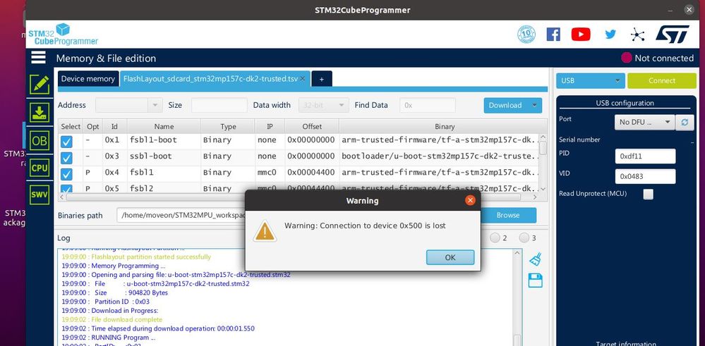

please check i getting this warning
MVENN.1
MVENN.1
When i flash the image in between connection is loss
