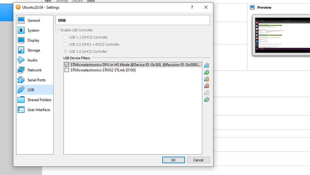

‎2020-11-25 9:07 AM
‎2020-11-26 1:19 AM
Hi Olivier GALLIEN ( ST Employee )
please check the below log file in Linux
Update me i really struct this probelm.

Looks like you loose target connection between :
$ STM32_Programmer_CLI -l usb
and
$ STM32_Programmer_CLI -c port=usb1 -w flashlayout_st-image-weston/FlashLayout_sdcard_stm32mp157c-dk2-trusted.tsv
Did you change anything in between ?
Can you check "STMicroelectronics DFU " device is still visible from you Virtual Box prior to launch the flashload command ?
Else I'm a bit puzzled since you previously report success in flashing but stuck in boot and I requested linux boot log console.
Please clarify.
Olivier
‎2020-11-26 2:30 AM
Hi Olivier GALLIEN (ST Employee )
Thank you for reply
Actually previous report is flashing succeed in windows platform.
I now flashing Linux(Ubuntu20.04 its getting error like
please check it.
Thanks.
