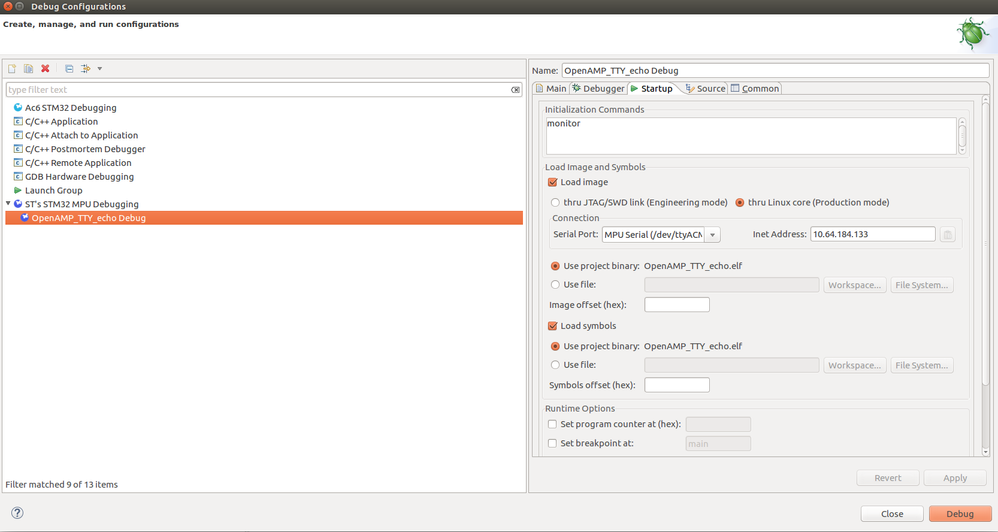

0690X000009813hQAA.pngIt uses OpenOCD (STLink) by default. Did you correctly set "thru Linux Core" in Startup tab, shown in the picture?

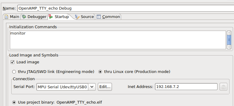

I had select the production mode on startup tab window.Below is the screenshot.

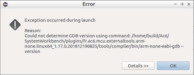

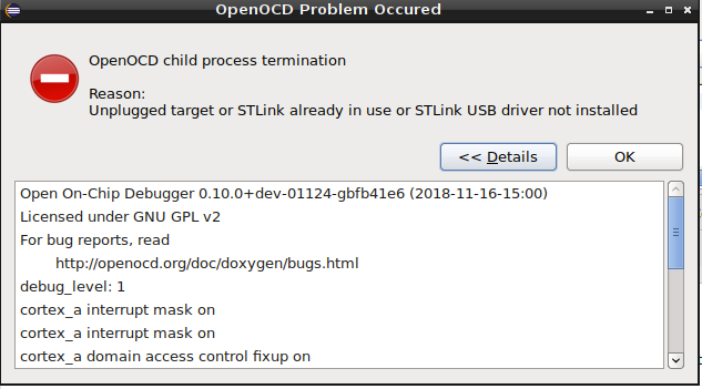

I use reinstall ubuntu 14.04 64bit to test it. It's also failed and got another error.
The system workbench debug cm4 need use serial port, stlink and ethernet.
