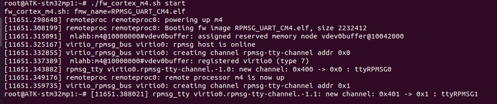

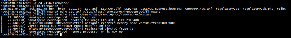

The MDK uses OpenAMP to communicate.Loading is not initialized at /dev/ttyrpmsg0.Programs are available in the IDE.
User.44
 MDK compiles, and the program loads the following results:
0693W00000Bd8ouQAB.png IDE compiles, and the program loads the following results:
0693W00000Bd8pxQAB.png The MDK program is exported from the IDE, and the two programs are the same
I want to use openamp in MDK, how can I modify it

Hello @文�?� �?​
A MDK project example integrating OpenAMP library is available here:
https://github.com/STMicroelectronics/STM32CubeMP1/tree/master/Projects/STM32MP157C-DK2/Applications/OpenAMP/OpenAMP_TTY_echo
