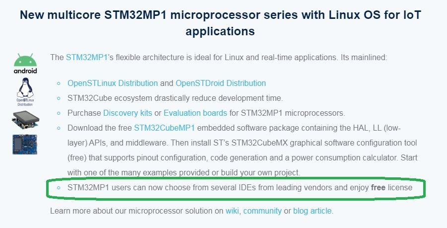

Hello, I have a question regarding ST marketing on the STM32MP1 devices. According to the page, it states "STM32MP1 users can now choose from several IDEs from leading vendors and enjoy free license"
PBart.3
Which IDEs can be used for free in order to download/debug my application in an asynchronous fashion as two cores are running the the same time. I have taken a look on some suppliers (Tools & Software), but it looks like that you need to pay a some money in order to use their eclipse-based IDEs. I mean, how can I evaluate if this MPU family is suitable for our project if I need to invest further money just for a license. I just want to make clear, I am not interested in trail licenses just for testing (limited amout of few kBs ). I would like to know if free IDEs without any bottleneck are available which allow me to develop/port my existing applications into this target? Where can I find it and if applicable where is the corresponding documentation?

No, not sure that's how I'd interpret the declaration that's being complained about
https://www.st.com/en/microcontrollers-microprocessors/stm32mp1-series.html
It is like the AND should be capitalized or something, as the two statements seem to be separate, like there are Pro Tools AND there's some other Free Stuff

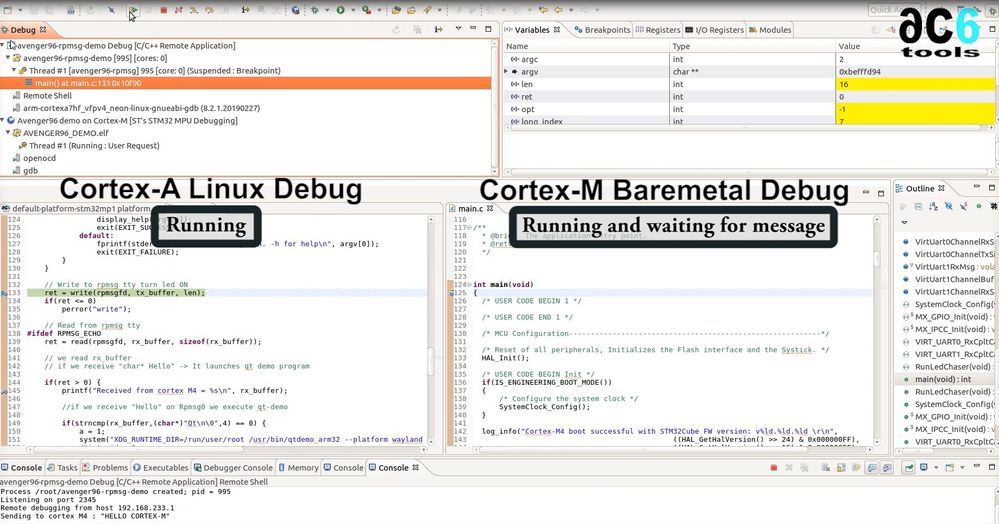

In one of the demonstration from Ac6 (SystemWorkbench4Linux) for the STM32MP1 (debugging both cores), I have seen following scenario:
Dummy data is shifted between both Cores (Cortex-A7 and Cortex-M4) as there is an integrated HW feature for processing intercommunication protocols (IPC).
This was illustrated via the debug session (see picture below):
Something like this is achievable on the STM32CubeIDE as shown above?

Hi @PBart.3​ ,
two concurrent debug sessions in one instance of CubeIDE are possible, see:
https://community.st.com/s/question/0D50X0000Byue7DSQQ/regression-with-cubeide-v120-breakpoint-ignored-
Some hints how to establish the debug sessions:
https://community.st.com/s/question/0D53W000003K9uVSAS/how-to-setup-eclipse-for-for-cross-compilation-and-cross-debugging
https://community.st.com/s/question/0D53W000004HK91SAG/how-to-connect-and-debug-cortexa7-cores-on-stm32mp157cdk2
In latest CubeIDE you don't have to create new ssh connection, done automatically.
