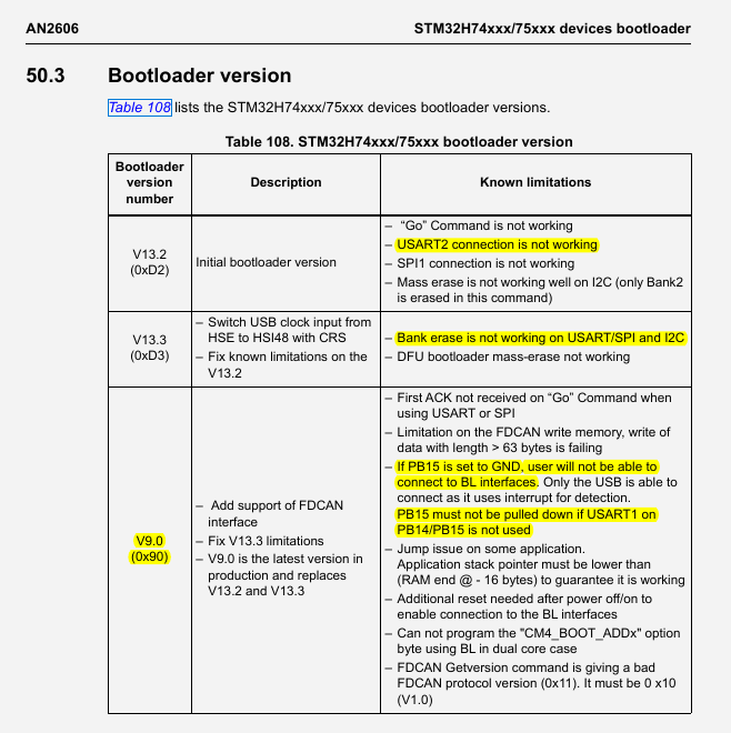

Refer to AN2606 “Configuration in System Memory Boot Mode” tables. Each device will have a specific System Memory/Bootloader address, and this value must be known to jump to bootloader correctly.
For example, for the STM32H723ZG microcontroller (a quick article showing the code for this series is available here), the Bootloader doesn’t start from the same address as the System Memory, but this is clearly defined in Table 111.

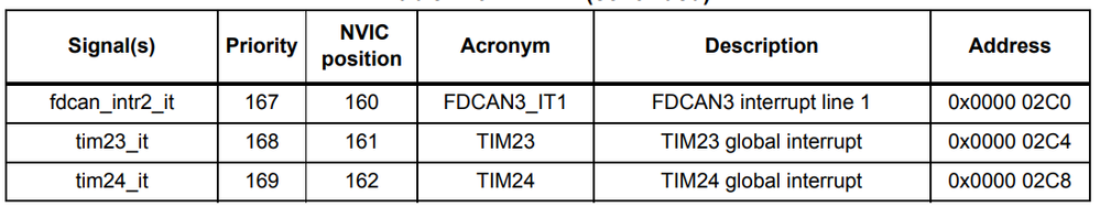

Including Clock Structure, Systick timer, ISR, Peripheral initializations and GPIO, every peripheral settings must be set to their default states to avoid interruptions when system is in boot mode. That’s why it is of the most importance to deinit all these functions and prevent an interruption to happen without a proper handler.
With the registers cleared, the interrupts can be re-enabled without compromising the application while in Bootloader.

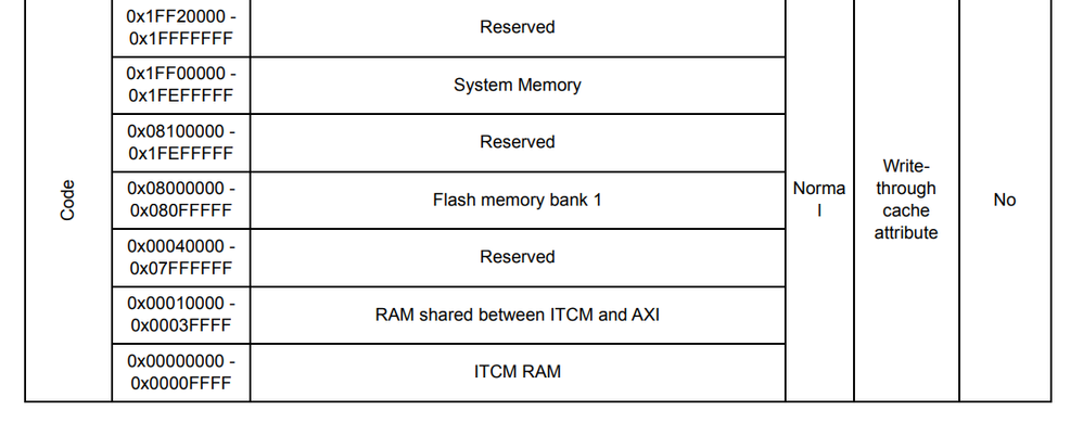

There are different useful ways to test if the code worked successfully, two of them are explained below.
You can check whether the PC is set to the Flash or Boot address in the debug tab on the top left corner of the debug perspective. At first, the PC starts in Flash address: 0x08000614 (for this particular demo).
After entering the Bootloader, the PC is now set to an address inside the Boot region: 0x1FF127BC. You can see the tab below after hitting “pause” button.
Once within the Bootloader region, we can use the STM32CubeProg to guarantee that the system is working in system boot mode.

Obs.: Please pay attention to the pins specified in the AN2606, because even if the STM32CubeIDE allows the pin reallocation, to enter in bootloader the pins must be the same as in the Application Note.
