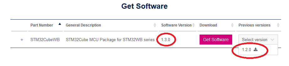

Why is the STM32CubeWB 1.3.0 package not available for download anymore? Is there a reason not to use 1.3.0? When will there be a full (usable) integration of the STM32WB in CubeMX or CubeIDE?
TWirt.2061
2 REPLIES 2
Remi QUINTIN
​Version 1.3.0 is the version by default when you click on the "Get Software" box, The can use a previous version clicking on the "Select version" box.
STM32WB is fully supported by CubeMX and CubeIDE. Note that CubeMX is now part of CubeIDE.
