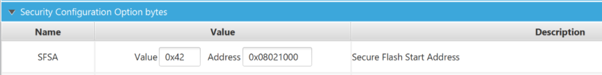

In order to determine the maximum FLASH length available for the application, you can look the value of SFSA option byte after flashing the wireless stack and deduct the length:
Maximum Flash available for the application = (SFSA address - 0x08000000) / 1024
Best Regards

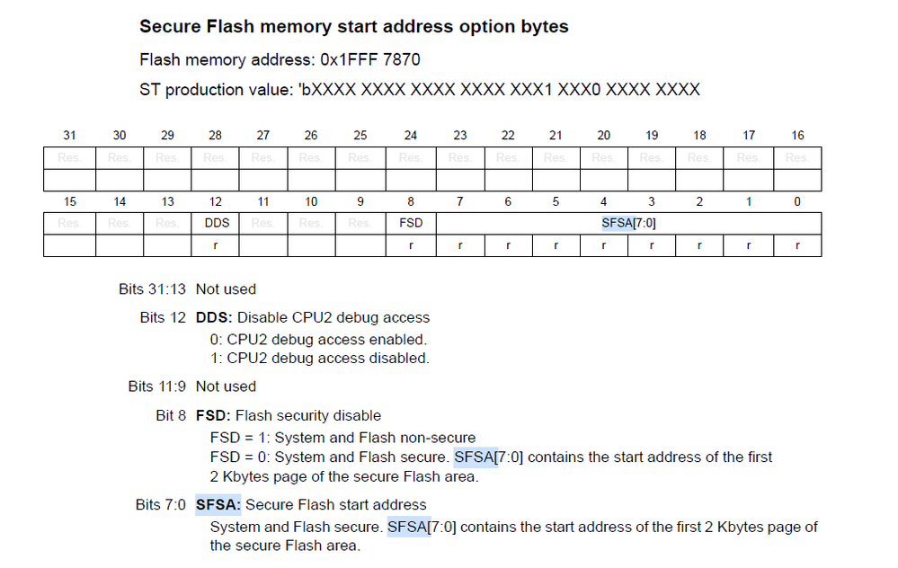

From the reference manual, SFSA option bytes are stored at flash memory address 0x1FFF7870.

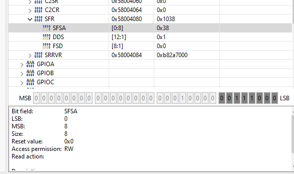

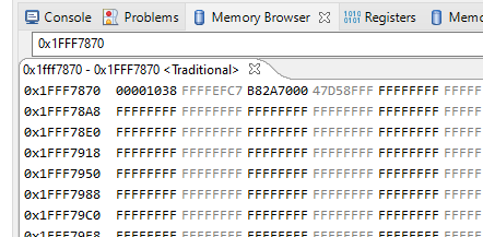

0693W00000QMHJwQAP.pngFrom the CubeIDE, SFR address location is 0x58004080 and SFSA value is 0x38. I checked both addresses 0x1FFF7870 and 0x58004080 and the value at these addresses are 0x1038. Which one is considered as SFSA address? None of these addresses are giving me the maximum flash available when placed in the formula given above.0693W00000QMHLTQA5.png0693W00000QMHLnQAP.pngSystem and Flash secure. SFSA[7:0] contains the start address of the first 2 Kbytes page of
the secure Flash area. So, in this case SFSA value is 0x38. Is this kind of an offset? How can I use this value?

In order to read the SFSA option byte, you can use STM32CubeProgrammer tool like this:
0693W00000QMHlHQAX.pngThe SRAM2 is shared between the CPU1 and the CPU2, so only a part of the SRAM2 is dedicated to the CPU1.
Best Regards
My SFSA value is 0x0801c000 and this indicates that my FLASH size is 112KB. Am I right? Why this value is different than the values mentioned in the created linker script and in the reference manual?
Remy ISSALYS
Yes you have right, in your case you have 112 KB of flash available for your application (CPU1). The value mentioned in the linker script is the maximum flash size allocated for the application, this value can't exceed the 112 KB in your case. The value mentioned in the reference manual is the total flash size available.
