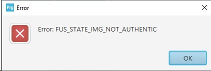

I just got my STM32WB55 Nucleo boards with FUS v.0.5.3 and trying to upgrade firmware but neither of the provided .bin files in "repository" ("stm32wb5x_FUS_fw.bin" or "stm32wb5x_FUS_fw_for_fus_0_5_3.bin") work. I get the same message for both when trying to program the files using STM32CubeProgrammer tool. (Note: message "Firmware Delete Successful" was present).
Attaching a picture of the error message I get.
Note: I tried to accomplish the same thing using both user USB DFU and ST-LINK interfaces.

10:45:12 : Error: FUS_STATE_IMG_NOT_AUTHENTIC

Try setting RDP option byte to 0xBB and then back to 0xAA.
Then try to upgrade the FUS once again.

Hello @AOris.1​,
It maybe the error caused by the previous FW installation.
Make sure to perform a partial mass erase of the flash memory and ensure a clean memory before any programming.

Thank you for the response but I must say that I have already tried that and yet still same error.​

Hi @AOris.1​ ,
There is step by step mentioned in FW release note describing how to upgrade/install the FUS :
How to flash the Wireless Coprocessor Binary via SWD/JTAG by ST-LINK (STM32CubeProgrammer GUI)

Can you please try it and tell me if it is OK ?

good points but I've been through those already... Here's the log:

11:05:04 : Erasing memory corresponding to segment 0:
11:05:04 : Erasing internal memory sectors [0 1]
11:05:04 : Download in Progress:
11:05:04 : File download complete
11:05:04 : Time elapsed during download operation: 00:00:00.289
11:05:04 : Application is running, Please Hold on...
11:05:11 : Reconnecting...
11:05:11 : Reconnected !
11:05:11 : Warning: FUS_STATE_IMG_NOT_FOUND, Flash already empty !
11:05:13 : Firmware delete Success
11:05:13 : Download Stack/FUS image at address 0x803a000 ...
11:05:13 : Memory Programming ...
11:05:13 : Opening and parsing file: stm32wb5x_FUS_fw_for_fus_0_5_3.bin
11:05:13 : File : stm32wb5x_FUS_fw_for_fus_0_5_3.bin
11:05:13 : Size : 24492 Bytes
11:05:13 : Address : 0x0803A000
11:05:13 : Erasing memory corresponding to segment 0:
11:05:13 : Erasing internal memory sectors [58 63]
11:05:13 : Download in Progress:
11:05:13 : File download complete
11:05:13 : Time elapsed during download operation: 00:00:00.655
11:05:13 : Firmware Upgrade process started ...
11:05:13 : Application is running, Please Hold on...
11:05:25 : Reconnecting...
11:05:25 : Reconnected !
11:05:25 : Error: FUS_STATE_IMG_NOT_AUTHENTIC
‎2021-10-04 8:15 AM
Imen,
IT WORKED!!!!!!!!!!!!!!!!!!!!! Thank you!!!!
‎2021-10-04 8:16 AM
Can you explain why this works, please?
‎2021-10-04 8:33 AM
Really glad that the issue is solved :smiling_face_with_smiling_eyes:
This is a trick to clean the flash that I used before upgrading the board, which helps to sort out from such unexpected situation;)
Imen
Thanks
Imen
‎2021-10-04 8:39 AM
Good enough for an answer. I was more interested in the details because I'm suspecting there's a bug in the fw/sw(?) But it's up to the ST engineers to figure that out and "outsiders" shouldn't be involved in the direct resolution process.
Thank you, again.
