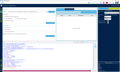

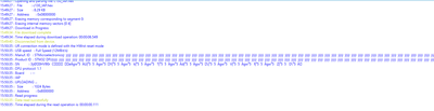

Hi, after doing a full chip erase over a device with a STM32F103, it's impossible to download a new version over DFU with the STM32CubeProgrammer. After I press connect it shows up corrupted data on the Manuf. ID, Product ID and Serial Number parametres, and when I tried to download the firmware it threw an error.
The program crash if I press to many times the USB refresh button and If I press programming a few times. We change a few things related to memory on the device and I guess we messed up with something but I don't know how to recover the MCU after this.

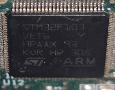

Are you sure that your "STM32F103" is genuine ?
I hope it is:grinning_face_with_sweat:. We've been working with this chip for a long time and this is the first time that this happens.
Connect via SWD (eg, using ST-Link) and do a full chip erase?
Done this over JTAG using the ARM ULINK plus debugger on Keil and got the same results, actually the first screenshot was taken after doing this process...
