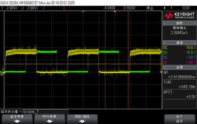

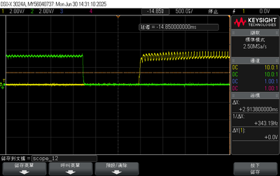

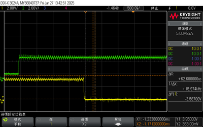

We are using the EVALSTDRIVE101 to drive a 250W, 1200RPM motor with Hall sensors. The Hall signals (H1, H2, H3) are filtered through the onboard RC low-pass filter before reaching the MCU on the NUCLEO-G474RE board.The control method uses 16kHz PWM to drive the UVW MOSFETs on the EVALSTDRIVE101.
When measuring the signals with an oscilloscope:
  • H1 shows minor jitter at high level.
  • H2 and H3 show significant jitter around 16Hz when high.
This noise seems to interfere with the motor commutation, resulting in audible "clicking" or "jerky" sounds and large speed fluctuations in the speed control loop during high-speed operation.

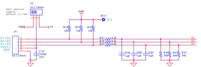

Interestingly, when we bypass the onboard low-pass filter on the EVALSTDRIVE101 and use an external RC filter instead, the noise is significantly reduced.
um2781-getting-started-with-the-evalstdrive101-stmicroelectronics.pdf   圖 4. EVALSTDRIVE101 –Hall sensors/BEMF

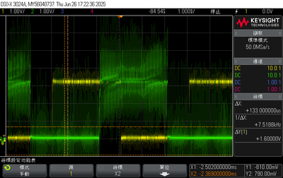

oscilloscope motor h1 green,motor ch2 yellow

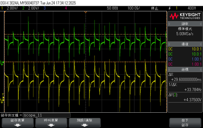

16k noise

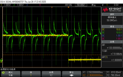

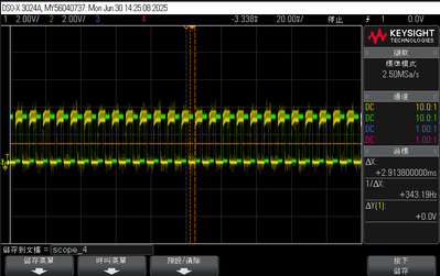

oscilloscope mcu h1 green PA15, mcu h2 yellow  PB3 RC low-pass filtered signal

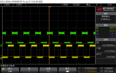

external RC low-pass filter

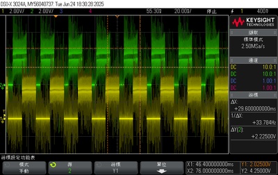

oscilloscope motor h1 yellow ,motor ch2 green
oscilloscope mcu h1 yellow  PA15, mcu h2 green  yellow  PB3 RC low-pass filtered signa
To rule out any issue with the motor itself, we tested the same motor using a different commercial motor driver.
Oscilloscope measurements of the motor-side Hall signals (H1, H2, H3) showed no 16kHz noise.
Therefore, we preliminarily ruled out a fault in the motor's internal Hall sensors and suspect the interference originates from the EVALSTDRIVE101 board.

  2. Use an oscilloscope to probe the Hall signals:
    • CH1: Measure H1 and GND on the EVALSTDRIVE101 board (green trace)
    • CH2: Measure H2 and GND on the EVALSTDRIVE101 board (yellow trace)
  3. Additionally, measure the filtered signals at the MCU input pins:
    • H1 (PA15) and H2 (PB3) on the NUCLEO-G474RE
  4. For external RC low-pass filter testing:
    • Remove jumpers J10, J11, J12 on the EVALSTDRIVE101
    • Connect external RC low-pass filters between Hall signal lines and MCU pins:
      • H1 → RC filter → PA15, H2 → RC filter → PB3
    • Measure the filtered signals again at PA15 and PB3

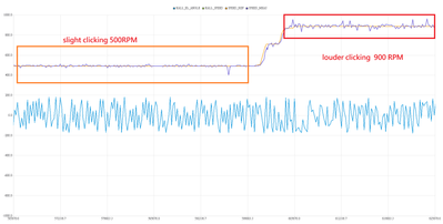

Do you have these "clicking" or "jerky" sounds at all RPM values?
Have you plotted the "HALL_EL_ANGLE" signal to check if computed angle is impacted by HALL signal noise?

Hello @GMA
Yes, I do hear the clicking sounds, and they are RPM-dependent.
My motor is rated for 1200 RPM. When operating around 400 RPM, there's already a slight clicking noise. As the speed increases to around 800 RPM, the clicking becomes noticeably louder.
However, when switching to the sensorless mode (using STO-PLL as the main sensor), the clicking sound disappears entirely.
