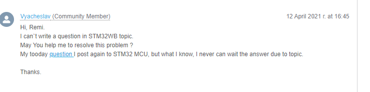

Peter BENSCH
Is it possible that this is your old thread?
Please keep in mind, that the community is a place for questions where users can benefit from the experiences of other users. Now that @Remi QUINTIN​ has helped you before, perhaps he will be so kind again?
Regards
/Peter

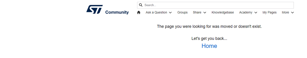

By the way, the problem was not solved in the specified thread either, so we still use the version of SDK 1.11 in the old device only because of the indicated problem.
And the thread about which I spoke, where the states of the register were indicated many times - it does not exist.
