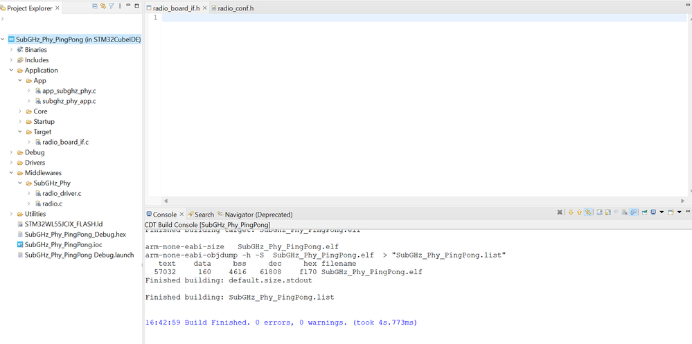

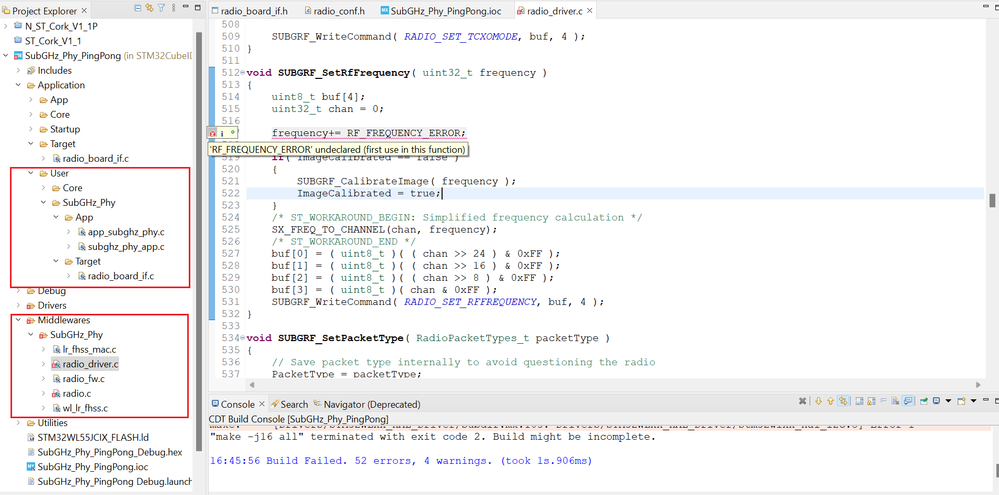

Hello, I'm practicing the "Point to Point Phy layer application lab" in the "MOOC STM32WL workshop" series.
After downloading the material and opening the project with CubeIDE and building the project, everything is fine.
however, when I try to add a peripheral like the I2C and generate the code, I always get a Board-Spesifications error.
For example, The Macro "RF_FREQUENCY_ERROR" was defined before the regeneration of the code.
I tried to delete the redundant files but it still doesn't work. i went around this by defining the peripheral manually and so far it's working, however it would be nicer and faster to have CubeMX working since the project is getting bigger.

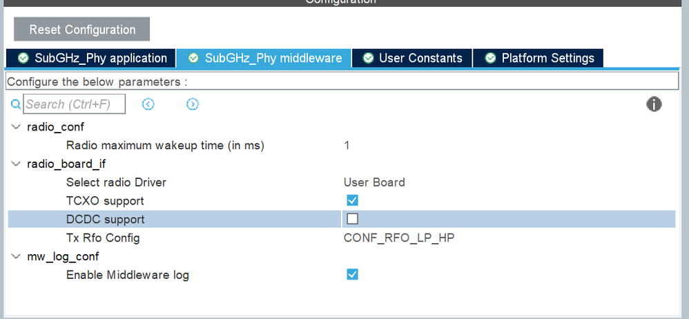

‎2023-04-11 6:23 AM - edited ‎2023-11-20 8:56 AM
Salam, I used the same STM32Cube_FW_WL_V1.3.0 firmware version -> Ping-Pong example.
setting the radio_board_if to User Board (Fig1) and receive the same issue(Fig2).
FIG[1]
FIG[2]

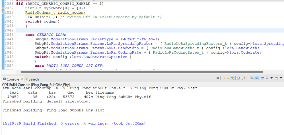

Removing all the Switch-Cases for the Non-LoRa-Modem(GFSK, GMSK) resolve the issue.
I suggest that ST adds a #ifndef for the different Modulation Codes, so only the dedicated code is the only one to be activated.
Thank you

Thank you Kauthar for your reply, I already know the "USER CODE BEGIN/END". What I experienced was an issue that I think it's a bug in CubeMX since the I2C Initialization code was not generated the first time but when I DeActivate the I2C then Genrates then ReActivate again, the MX_I2C functions appear in the main.c
Other Errors were removed by Commenting-out the Non-LoRa Sections from the source code (not a professional solution but it works). Lastly, I had to manually copy the BSP Files of the STM32WL Radio to the BSP folder and define the #define USE_BSP_DRIVER.
FIG[1]
FIG[2]

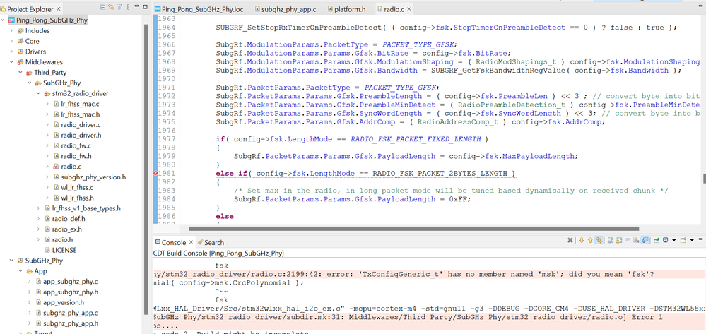

Thank you
Amir
‎2023-04-11 7:19 AM
Hi @AElgh​ ,
To solve the problem, please try:
1- To copy the .ioc file from the PingPong example into another folder and generate the code.
2- To build the project.
I hope this help you to solve the problem.
Thank you for your contribution in STCommunity :) .
Kaouthar
‎2023-04-13 4:37 AM
Thank you for your reply, unfortunately your suggestion didn't resolve the issue. for now, I'll stick with the deleting un-used-code method until I find a more proper way to do it.
