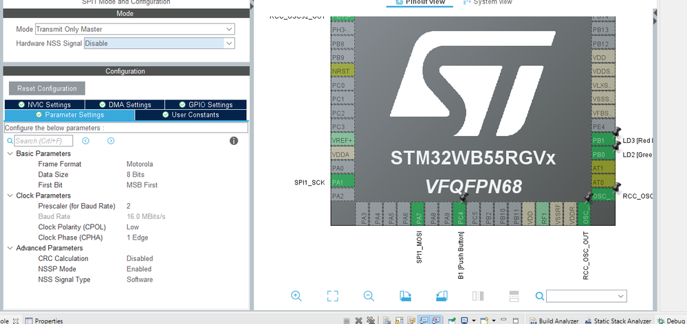

Hello. I am trying to setup SPI1 on the STM32WB55 nucleo board. I have setup the nucleo board with the default peripheral configuration using STM32CUBEMX and I have enabled SPI1 Transmit Only Master mode:

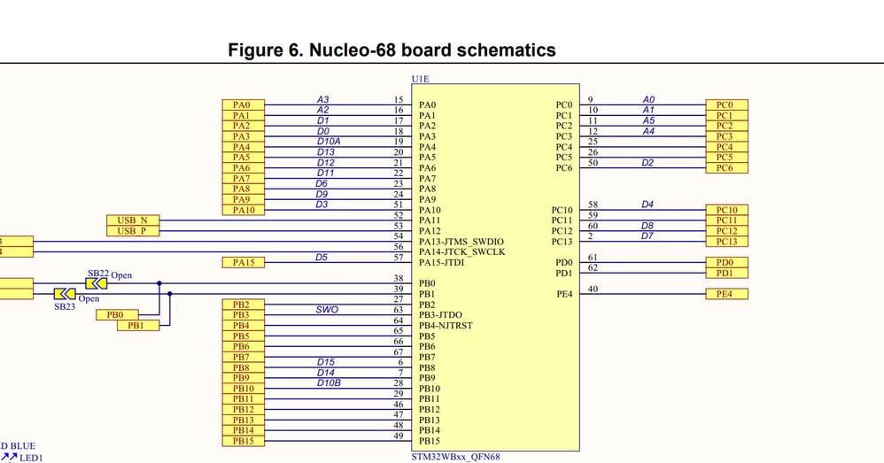

In my code, all I am trying to do is SPI1 transmit every 1 second and I use oscilosscope to probe SP1 clock pin ( supposed to be A2 pin on the header according to the stm32wb55 nucleo datasheet.

On the scope, the SPI1 clock is not toggling at all. Please suggest possible ways to debug/solve this issue
5 REPLIES 5
Mike_ST
I tried your code after quickly setting up a cubeMX project for this nucleo.
It is working.
I suspect you don't see the frame on the scope. Please try to remove the HAL_Delay, to have continuous transmission.

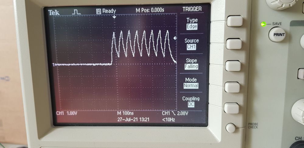

Hello. Thank you very much for the response. I am big noob debugging hardware and never really had an opportunity to have a look at SPI through an oscilloscope. I have managed to capture some sort of signal on clock pin with trigger option on my osciloscope. Please see the image below:
Does that look like a decent SPI clock? I have measured the time difference between the start of the spike and end of the spike and it looks like 60ns
Near 62.5ns + 8 spikes, it works.
The signal is not square at all.
Maybe your probe/scope need to be calibrated.
LPetr.1
Senior II
Once I have set the prescaler to 256, the signal is square. Now the clock period is 125Khz and that is correct since the CPU cluck frequency is 32Mhz/256 = 125kHz. Maybe my scope is too old to handle 16Mhz? Anyways, thanks. That confirmed the SPI is working as expected
