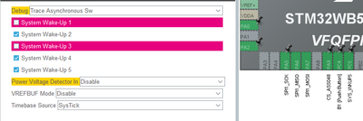

‎2024-12-13 6:07 AM
Hello @eloibonte @HSpre.1 @jirdom
I am working on a project with the STM32WB55
Even a long time after, I wondered if you had found a solution to your problem. I encounter the same situation and I don't know what to do.
I have a timer that after 5 sec launch the offmode :
HAL_GPIO_TogglePin(LD3_GPIO_Port, LD3_Pin);
count++;
if (count > 5)
count = 0;
//HAL_PWR_DisableWakeUpPin(PWR_WAKEUP_PIN1);
//HAL_PWR_DisableWakeUpPin(PWR_WAKEUP_PIN2);
//HAL_PWR_DisableWakeUpPin(PWR_WAKEUP_PIN3);
//HAL_PWR_DisableWakeUpPin(PWR_WAKEUP_PIN4);
HAL_PWR_DisableWakeUpPin(PWR_WAKEUP_PIN5);
/* Clear all related wakeup flags*/
__HAL_PWR_CLEAR_FLAG(PWR_FLAG_WU);
/* Enable WakeUp Pin PWR_WAKEUP_PIN2 connected to PC.13 */
//HAL_PWR_EnableWakeUpPin(PWR_WAKEUP_PIN1);
// HAL_PWR_EnableWakeUpPin(PWR_WAKEUP_PIN2);
//HAL_PWR_EnableWakeUpPin(PWR_WAKEUP_PIN3);
// HAL_PWR_EnableWakeUpPin(PWR_WAKEUP_PIN4);
HAL_PWR_EnableWakeUpPin(PWR_WAKEUP_PIN5);
PWR_EnterOffMode();
With this example, I do enter in Off mode (the Led stop to blink). But none (even if uncomment ) of the wake up pin work. (The led do not goes to blink)
But there are correctly set as you can see:
