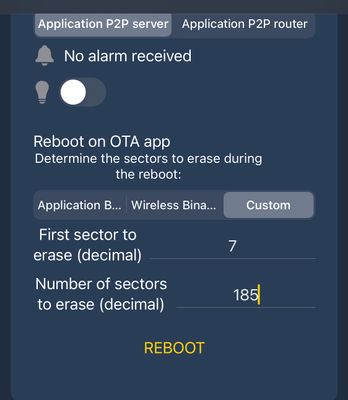

November 12, 2024
I had a similar problem. Whenever the firmware is updated through OTA loader, the firmware file was successfully transferred but the system just got stuck after then. Even if the the system is restarted, the previous firmware is remaining.
After getting through some struggles, what I found and checked was...
(1) When the flash is entirely formatted (but excepting memory for CPU2 (e.g. after 0x080CB000)) and a fresh OTA loader was installed, the initial application firmware update was successful through OTA . But once any of application firmware was updated, the firmware update through OTA never works. This implies any remaining code other than OTA loader and CPU2 may cause the problem.
(2) In the STM32 BLE Toolbox app, before reboot the device to put into OTA mode, you can specified how much of sectors is going to be erased in the "Custom" tab. If an entire free area (e.g. Sector 7 to 191, total 185 sectors starting from Sector 7) are erased, it was found that any OTA firmware could be successfully and normally updated. I guess this number of sector will be model(memory size)-sensitive. If total number of sector exceeds this value, the device cannot be found in the toolbox because codes in CPU2 sector are deleted.
I am not sure this could solve your problem as well, but please give it a try.
