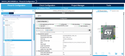

I am using the NUCLEO-WB15CC board for a custom application where I read an analog sensor value with a 12-bit ADC resolution. The issue arises when I try to transmit this data over BLE. I am using the following code to update the BLE characteristic:
In the BLE Toolbox app, I see the hex value `0x0F` when I connect 3.3V to the analog pin. Since `0x0F` is not the expected equivalent of 4095, I believe the data isn't being transmitted correctly. However, when I use `APP_DBG_MSG` to print the ADC value in the Serial Terminal, I can correctly see `4095`.

‎2024-10-22 11:14 PM
Hi, change the "Value Length" parameter to "2" which indicates 2 bytes.
Hope that helps.
