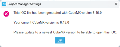

On some projects, when trying to open a .ioc, I get this:
Why is this so broken :(?

I tried installing an older version of STM32CubeMX and I get this error:
I guess there's no going back now :(.
Kindest regards.

As per your suggestion, I also installed STM32CubeIDE v1.18.1 and get the same error I get from STM32CubeMX.
Kindest regards.
