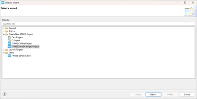

I've tried creating a new project in CubeID for an STM32F401CEUx.
But the project "STM32 Project" doesn't appear in the list of new projects.
The closest thing I find is one called "STM32CubeIDE Empty Project," and when I create a project using this template, the initial image of the chip where I configure the pins doesn't appear, and the IoT file isn't in the project tree either.
Why could this be?

But it sounds like you're using v2.0.0, and following an out-of-date tutorial.
In v2.0.0, the CubeMX functionality was removed from the IDE, and now exists only as a standalone application.
See: STM32CubeIDE 2.0.0 released
Explanation & discussion here: IDE Version 2.0.0 - why remove MX ?
New tutorial here: STM32CubeIDE 2.0.0 workflow tutorial
Note that CubeMX has always been available as a standalone application, so older tutorials which use that workflow should still be valid.
