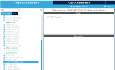

I've added the X-CUBE_AZRTOS-WB software pack and checked all the boxes for ThreadX but the RTOS ThreadX checkbox in STM32CubeIDE is disabled.  Is something else required to use ThreadX on an STM32WB?

If USB_DEVICE middleware is configured, you can't use the X-CUBE_AZRTOS-WB (they can't be used on the same project). So, to configure the X-CUBE_AZRTOS-WB, you have to disable the USB_DEVICE.
