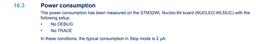

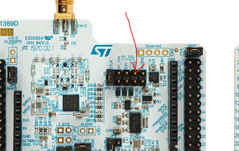

I want to check the low consumption in stop2 mode. I use directly the Sigfox_PushButton example of cubeWL
Page 71/79 of the AN5480 (Rev4 - July 2020) :

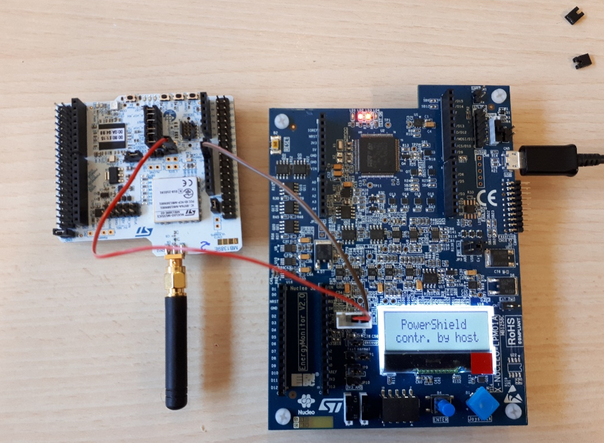

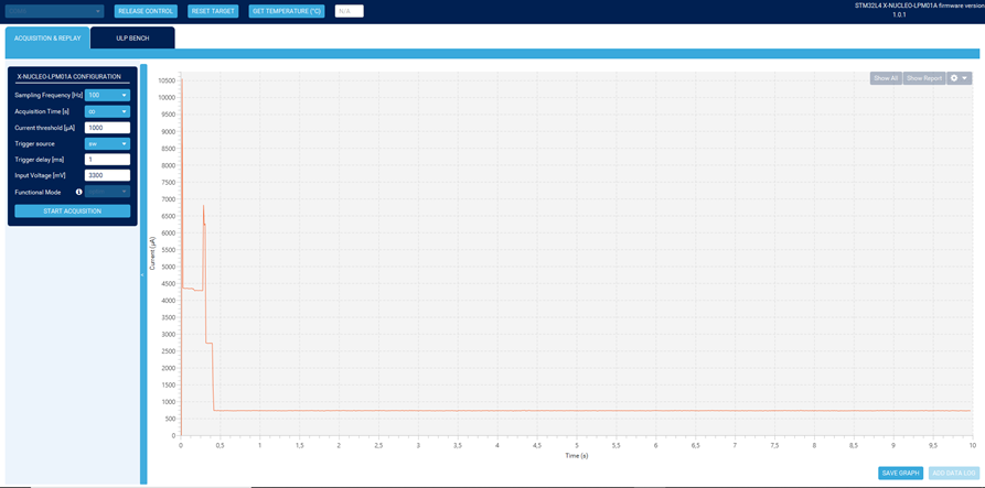

I use the X_NUCLEO-LPM01A to measure the consumption in stop mode. With this setup:
I supply the MCU through I_SoC (JP1) (at 3.3V)
I remove JP7 to remove LED5.
I remove STLK jumper (as shown in UM2592 P.22)
I measure : 725uA !!!
How in practice to measure these 2uA ?
Thank you
Best regards

‎2022-01-31 5:13 AM
Hello @LLr.1​
So, i confirm my expectations...
If you power the nucleo with USB (STLINK) + JP1 via X_NUCLEO-LPM01A, you get effectively the 2uA in STOP2 mode in the Sigfox example.
If you only power the nucleo via JP1 (X_NUCLEO-LPM01A) + remove all JP7 jumpers (so performs the measurement like shown in you first picture with JP7 removed) you get an overcurrent because of VDD_APP not beeing supplied (due to the RF switch U3). If you keep SB32 and solder a jumper on JP9 then disconnecting JP9 and you get your 2uA back (but RF is not functional anymore).
So yes, i agree with you best choice is to solder JP9 and supply both JP1 + JP9 external with X_NUCLEO-LPM01A.
Another remark, i have noticed that putting the fingers around JP7 create can also create overconsumptions. It is expected as you left in a dangling state VCP_RX & VCP_TX. So to keep traces functional and avoid extra consumptions due to noise, pull-up PA2/PA3 (GPIO_InitStruct.Pull = GPIO_PULLUP;)

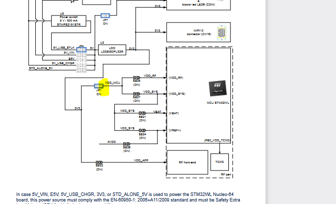

‎2022-01-28 12:48 AM
Hello @LLr.1​
In the above measurement, you have to power-up the LDO (component U2) Figure 10. STM32WL Nucleo-64 board power tree because 3.3V is needed to supply the VDD_APP.
If you want to only supply the board through X_NUCLEO-LPM01A only, i would suggest to supply MCU through JP1 BUT keeping JP1 closed and unsolder SB1 to remove connection to LDO (otherwise it is seeking current when unpowered)
BR,
Bruno
‎2022-01-28 1:36 AM
Thank you for your reply
OK, but removing SB1 is permanent. Can I solder a jumper ? (as I can be done with SB28/JP2 or SB27/JP3). (In order to change after this single measurement to 5V USB supply to flash the code et cetera.)
Nevertheless, I don't understand how the LDO can seek current because I supply thought JP1 which is open. see screenshoot :

Seeking current though SB1 is not permanent but happens more on wakeups & TX/RX RF phases (as VDD_APP) is required. So it is just an advice to measure the consumption of the whole board without external power supply (ex USB STLINK connection) and reach the minimum consumption in the MCU range 1.71v to 3.6v.
Yes, you can solder a jumper. µ

By powering STLINK and VDD_APP, What do you mean? To supply at 3.3V, like done in Figure15 ?
ok, but where ?
To have VDD_APP, maybe I can supply 3.3V with the X_NUCLEO-LPM01A at JP1 and JP9 in same time. (with SB32 removed). What do you think ?
To sum up, I just would like to measure the 2uA with your current measurement board called X_NUCLEO-LPM01A (in a reversible way for the board in order to be able to use it after the USB charger at 5V)
Thank you
Best regards
‎2022-01-28 5:46 AM
Yes, of course supplying both JP1 and JP9 is ok also ;)
After checking the consumption with X_NUCLEO-LPM01A, you can supply externally both though 5V_USB_CHRG going through LDO U2.
BR,
Bruno

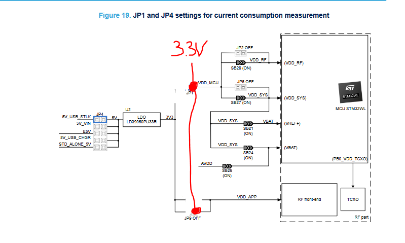

‎2022-01-28 7:14 AM
Thus, if I understand well your measure 2uA by removing SB1 and after I have to use external wires to feed in 3.3V JP1 and JP2 with the pin here ? :
Best regards
‎2022-01-28 8:09 AM
Let me do the same setup as you & i will get back to you soon.

‎2022-01-31 5:13 AM
Hello @LLr.1​
Do you confirm it is now ok on you side ?
BR,
Bruno
PS: Please select as best answer to improve stcommunity experience

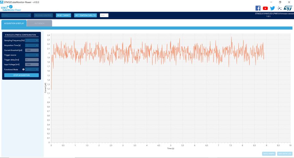

‎2022-02-07 4:49 AM

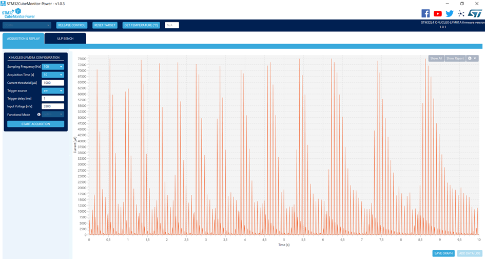

Thank you, I tested it on my side
1) "only power the nucleo via JP1 (X_NUCLEO-LPM01A) + remove all JP7 jumpers (so performs the measurement like shown in you first picture with JP7 removed) you get an overcurrent because of VDD_APP not beeing supplied (due to the RF switch U3). If you unsolder SB32 and solder a jumper on JP9 then disconnecting JP9 and you get your "2uA back (but RF is not functional anymore)." -> Ok, I have 2ua
2) "solder JP9 and supply both JP1 + JP9 external with X_NUCLEO-LPM01A." -> Ok, I have 2ua
3) "If you power the nucleo with USB (STLINK) + JP1 via X_NUCLEO-LPM01A, you get effectively the 2uA in STOP2 mode in the Sigfox example." -> I don't have 2uA each time. I have (Is it the noise you talk about ?) : And if I restart the acquisition few times, I can have sometimes :
Thank you
Best regards
