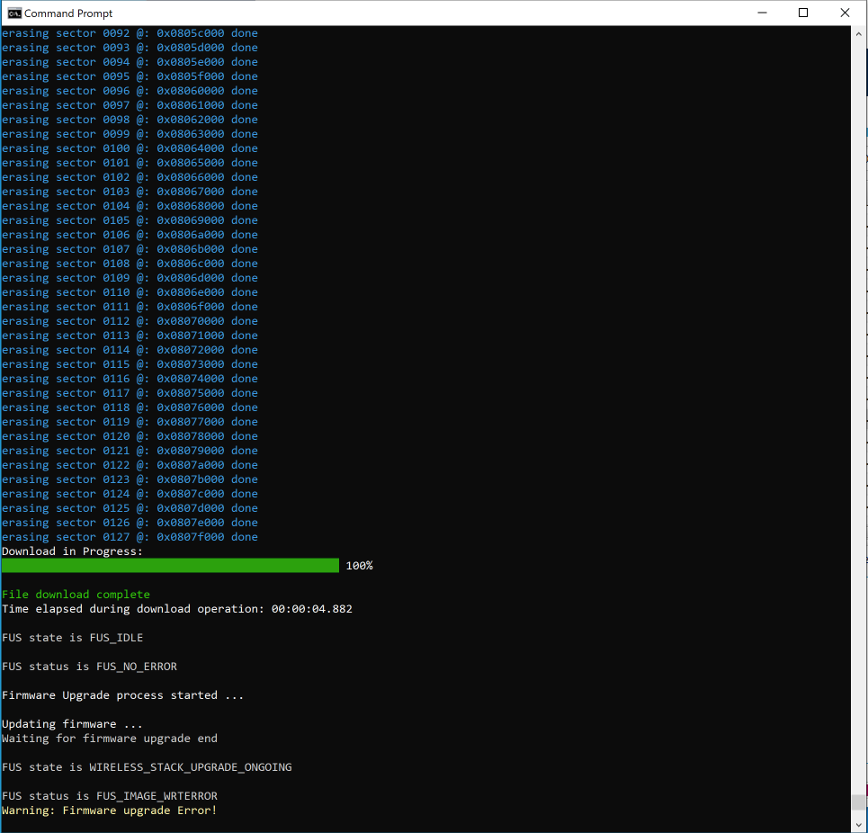

I'm running FUS 1.2.0 on an STM32WB55CEU and every time I try to update the BLE firmware over USB I get a FUS image write error. It appears to download and verify successfully but always fails during the actual firmware update. I can't seem to find this error anywhere else on the forum (or Google) so am I the only one having this issue?

 08:59:13 : Firmware Upgrade process started ...
 08:59:13 : Updating firmware ...
 08:59:13 : Waiting for firmware upgrade end
 08:59:17 : FUS state is WIRELESS_STACK_UPGRADE_ONGOING
 08:59:17 : FUS status is FUS_IMAGE_WRTERROR
 08:59:17 : Firmware upgrade Error!

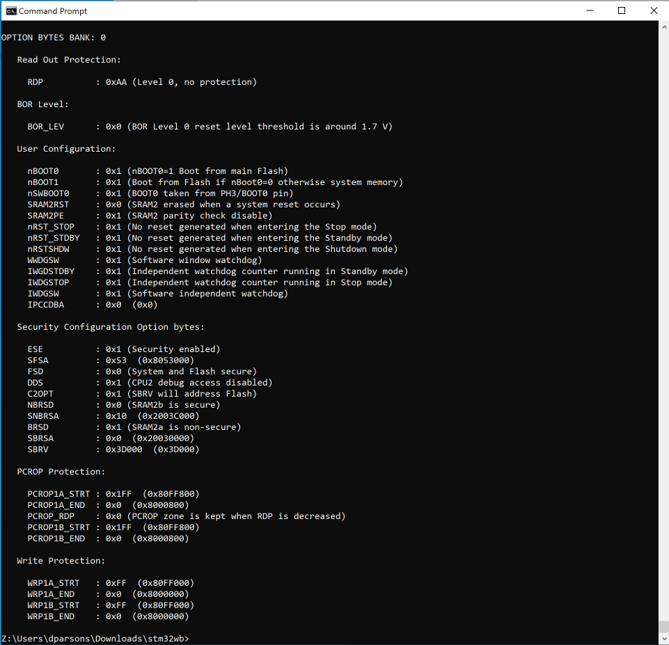

Well, I didn't really find the root cause but I've at least found a work around. All the failures were happening when I tried to update through USB DFU. I was also powering the board through USB. This board also has test point access to the SWD pins so I changed my set-up to power the board with an external power supply and connect STM32CubeProgrammer via SWD and now it programs successfully. There is obviously some sort of hardware issue with my USB connection.

Same failure from command line and option bytes...
