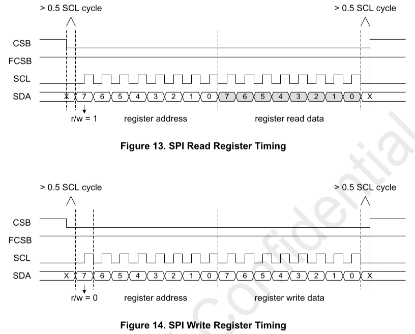

I'm using a P-NUCLEO-WB55 for an SPI application with a CMT2219A (HF receiver) which works in Half duplex.
I try to read its configuration registers by sending the address with the R/W bit set, then reading the bus by clocking during a byte (see the following picture:)

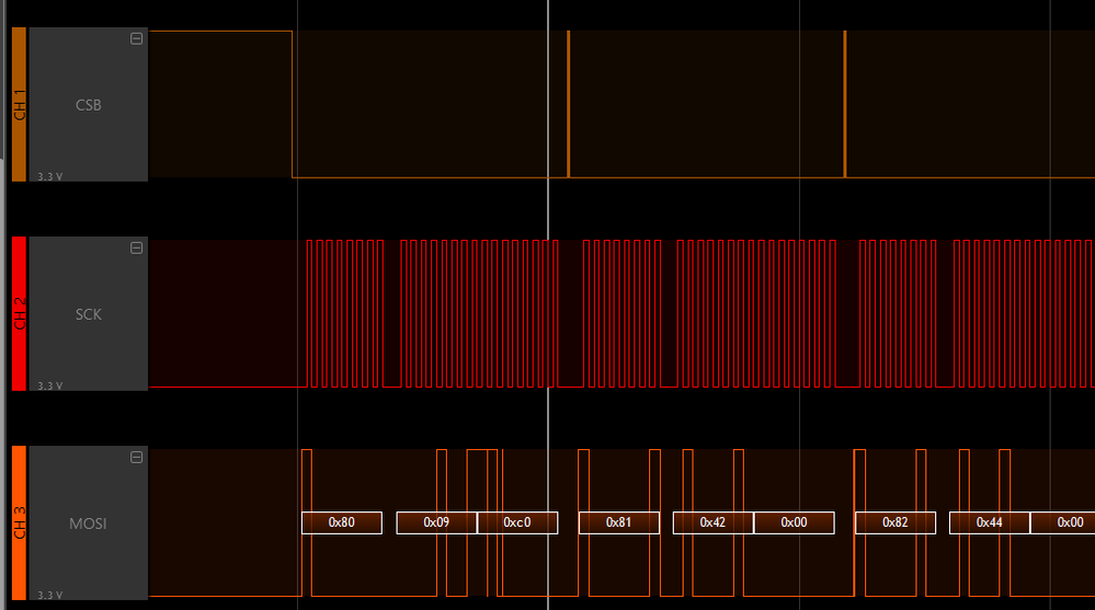

0693W00000NqsGdQAJ.pngThe problem is that when reading, the MCU is clocking during 2 bytes instead of 1 as you can see:
0693W00000NqsFuQAJ.pngIf I try to read 2 bytes, then the MCU is clocking during 3 bytes and so on...
Actually, the values read on the picture are correct, but we're loosing time reading an extra byte each time (and this is not clean even if this doesn't affect the integrity of the data).

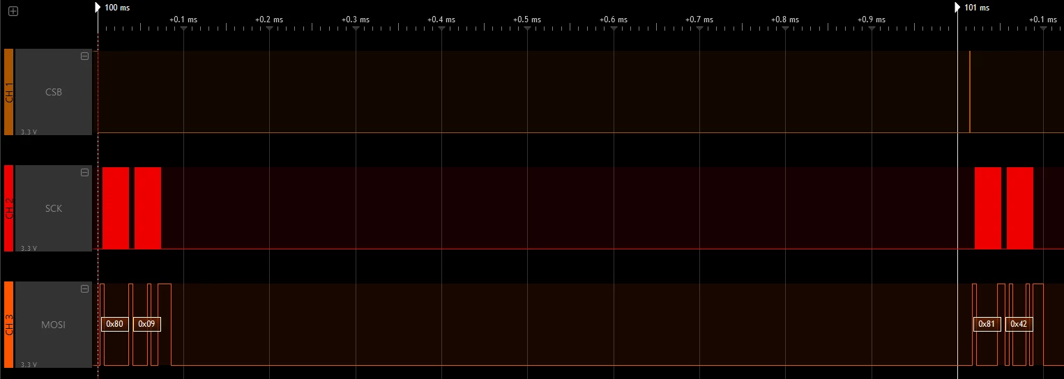

It provides some quite good results but the peripheral waits to reach the timeout every time while the data has been successfully read:
0693W00000Nr5KiQAJ.pngIs there a way to make the peripheral understand that the reception is complete?
