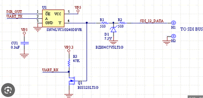

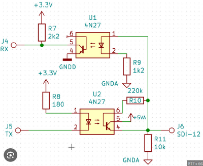

I am trying to communicate with an SDI-12 sensor using STM32L072CZY6TR. I'm using UART half-duplex with the following configuration:
  • Baud rate: 1200
  • Word length: 7 bits
  • Parity: Even
  • Stop bits: 1
My questions:
  1. Do I need a UART to SDI-12 converter module, or can I connect the sensor directly to the STM32?
  2. Do I need signal inversion, and if so, should it be done in hardware or software?
  3. What pull-up resistor value is recommended for the SDI-12 data line?
My current understanding:
  • SDI-12 uses inverted logic compared to standard UART
  • SDI-12 requires a pull-up resistor on the data line
  • Level shifting may be needed between 3.3V and 5V
Has anyone successfully implemented SDI-12 communication with STM32L0 series? Any schematic examples or code snippets would be greatly appreciated.
Thank you!

AScha.3
no.
see : https://www.sdi-12.org/current_specification/SDI-12%20Specification%201.4%20February%2020%202023.pdf
The data line is a bidirectional, three-state, data transfer line.
right. Its 5V level rx + tx , so i would use something like   74LVC1T45GW   (single line driver).
1x at 5V supply, to drive the signal line, 1x 3v3 at cpu side.
from search, typical interface :
Using UART for SDI-12 interface
