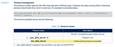

Andrew Neil
May 23, 2025 10:07 AM UTC
@Karl Yamashita wrote:
Don't use HAL_MAX_DELAY. That is ~49 days before it'll timeout.
Actually, I think the HAL_UART_Receive takes HAL_MAX_DELAY to mean infinite timeout; ie, it will wait forever?
The name (or, at least, the usage) is misleading.
PS:
found it:
https://community.st.com/t5/stm32-mcus-products/ultrasonic-a02yyuw-not-working-in-stm32l443vct6/m-p/731949/highlight/true#M263525
Karl Yamashita
May 27, 2025 5:22 AM UTC
Yes, you are right. I just looked at the 32 bit value but didn't look to see what UART_WaitOnFlagUntilTimeout actually did.
If a reply has proven helpful, click on Accept as Solution so that it'll show at top of the post.CAN Jammer an open source CAN bus hacking toolCANableV3 Open Source
