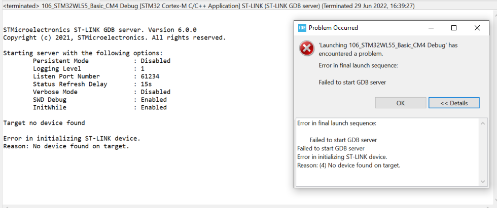

I bought a nucleo-wl55 card from RS.
At the beginning, it worked very well and i started to develop my application.
Suddenly today, when i try to run my program, i get an error message : st-link cannot detect a target.
And the card become very hot !
Any suggestion !

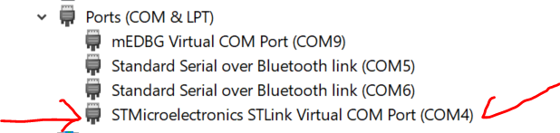

when i connect the card i can detect the virtual com port :

The connectivity of the STM32 Target, and the presence of the ST-LINK in Windows are two different things.

I have upgraded to the last version 1.10, connected under reset and pulled high boot0 pin ... but always the same problem.
effectively, i know that st-link is different from target, but is to verify that at least the programmer is working well.

I have also tried to connect with an external j-link (to verify if the problem came from st-link) but always the same problem (no target detected)
