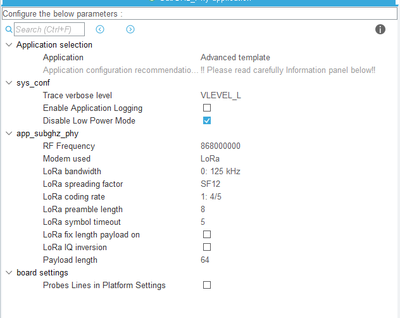

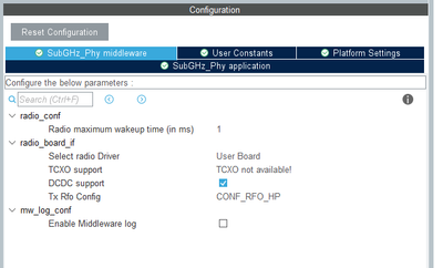

I tried the same with my STM32WL55-Nucleo. I configured the RF switch pins for HP usage
and the SubGHz middleware with the LoRa settings
Then I use the following code to transmit a test message after the initialization of the SubGHz middleware

Radio.SetChannel(868000000);
Radio.SetTxConfig(MODEM_LORA, TX_OUTPUT_POWER, 0, LORA_BANDWIDTH,
LORA_SPREADING_FACTOR, LORA_CODINGRATE, LORA_PREAMBLE_LENGTH,
LORA_FIX_LENGTH_PAYLOAD_ON,
true, 0, 0, LORA_IQ_INVERSION_ON, 3000);
Radio.SetRxConfig(MODEM_LORA, LORA_BANDWIDTH, LORA_SPREADING_FACTOR,
LORA_CODINGRATE, 0, LORA_PREAMBLE_LENGTH, LORA_SYMBOL_TIMEOUT,
LORA_FIX_LENGTH_PAYLOAD_ON, 0, true, 0, 0, LORA_IQ_INVERSION_ON,
true);
Radio.SetPublicNetwork(true);
Radio.SetMaxPayloadLength(MODEM_LORA, 128);
Radio.Sleep();
uint8_t Buffer[] = {
0x3C, 0xFF, 0x01, 0x44, 0x4F, 0x32, 0x44, 0x4B,
0x48, 0x2D, 0x37, 0x3E, 0x41, 0x50, 0x4C, 0x47,
0x30, 0x31, 0x3A, 0x21, 0x34, 0x39, 0x33, 0x32,
0x2E, 0x30, 0x35, 0x4E, 0x4C, 0x30, 0x31, 0x30,
0x34, 0x37, 0x2E, 0x35, 0x30, 0x45, 0x26, 0x54,
0x65, 0x73, 0x74, 0x32
radio_status_t status = Radio.Send(Buffer, sizeof(Buffer));
/* USER CODE END SubghzApp_Init_2 */
But I don´t receive the message with my gateway and "OnTxDone" isn´t called despite a successful transmission indicated with "RADIO_STATUS_OK" in "status".
What is missing here?
