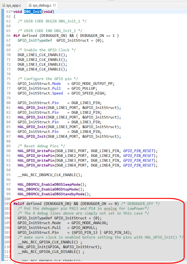

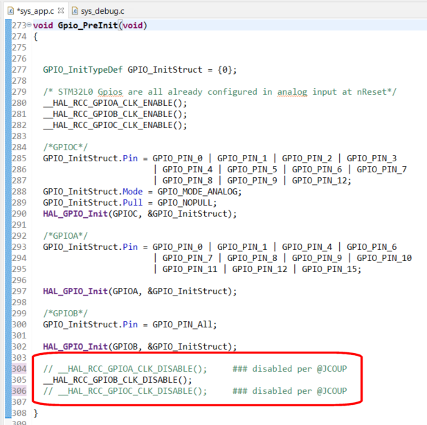

'To solve the hard fault (I do have to check completely why) do disable the debug mode ( in sys_app.c the DBG_Init() function). In addition in the Gpio_PreInit() function put in comment the two "__HAL_RCC_GPIOA_CLK_DISABLE()" and "__HAL_RCC_GPIOC_CLK_DISABLE() " statement.'
If I do that, I still get no AT Command transmitted and, because the debug connection is now disabled, I cannot see what is happening - whether it's Hard Faulting or not!
(I am spying on only the L072 Transmit - as I can do that with just the ST-Link without also having to get out any FTDI cables).
ADDENDUM
So we're here:

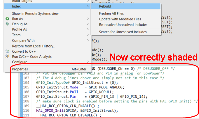

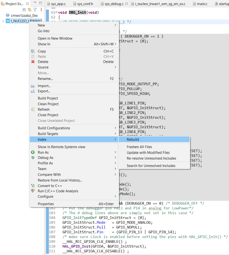

Disabling these lines in Gpio_PreInit():

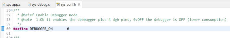

I've disabled Debug:
But the CubeIDE highlighting doesn't recognise it:
0693W00000BdaZdQAJ.pngAlthough stepping in the debugger does show that it executes the greyed-out code!
How do I re-sync the highlighting in the CubeIDE? Closing & re-opening didn't help.

Found it:
JCOUP

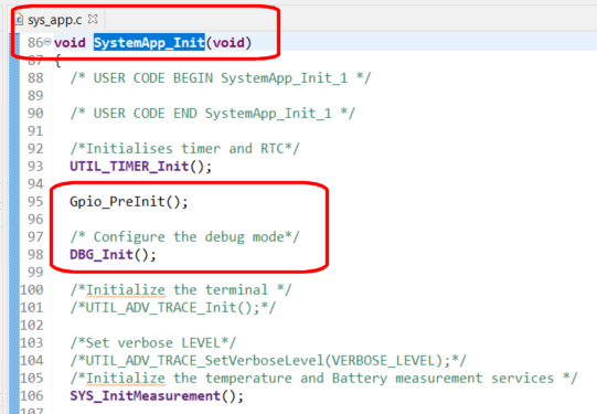

Andrew , Ok can you just put in #if 0 DBG_Init() #endif . Just to avoid to spepping in the debugger code.
The code is building correctly - it is doing the "DEBUGGER OFF" part - it's just the IDE that was incorrectly shading the source in the editor.
This was fixed by doing the Index > Rebuild:
If I comment-out the call to DBG_Init():
  * @brief initialises the system (dbg pins, trace, mbmux, systiemr, LPM, ...)
  * @param none
  * @retval  none
void SystemApp_Init(void)
  /* USER CODE BEGIN SystemApp_Init_1 */
  /* USER CODE END SystemApp_Init_1 */
  /*Initialises timer and RTC*/
  UTIL_TIMER_Init();
  Gpio_PreInit();
  /* Configure the debug mode*/
  //DBG_Init();	                   	### disabled per @JCOUP
  /*Initialize the terminal */
  /*UTIL_ADV_TRACE_Init();*/
  /*Set verbose LEVEL*/
  /*UTIL_ADV_TRACE_SetVerboseLevel(VERBOSE_LEVEL);*/
  /*Initialize the temperature and Battery measurement services */
  SYS_InitMeasurement();

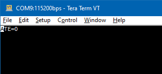

Then I do se one AT Command sent:
But then nothing more happens.

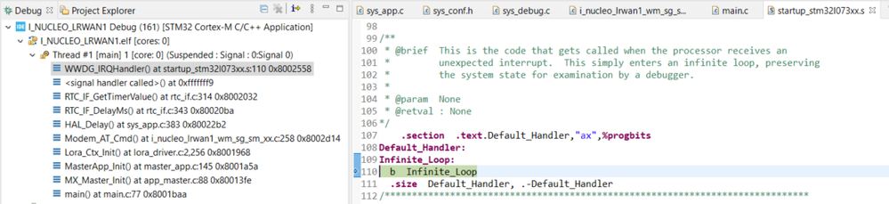

If I halt the debugger, it's in the Default_Handler again - another Hard Fault ?
Maybe it's not actually a Hard Fault - some other unhandled interrupt ... ?

oK , we see the TX (ATE is a md to disable echo). Normally after we must have the AT cmd to see is the modem is ready and then the AT+JOIN=1. Should seem that problem come just afetr ( yes could be unexpected interrupt ???). Could to could plug the spy on the RX ( modem to master transmission) to see the return value coming from Modem. Is it possible for you to to step by step up to the Lora_fsm() (line 99 - app_master.c file)
JCOUP
Andrew, Here are some fixes to solve the problem . Main problem encountered was du to a less memory array allocation. Was already present in the previous version of the package (1.3.1) but without board effect !!! (could be possible following the final mapping organization provided by the linked).
in lora_driver.c in line 81 --> replace 16 by 32 size --> static uint8_t PtrTempValueFromDevice[32] ; /*to get back the device address in */
in sys_app.c --> just reorganize two statements UTIL_TIMER_Init() and Modem_IO_Init() in the SystemApp_Init(void) function
 /*UTIL_TIMER_Init();*/
 Gpio_PreInit();
#if 1
 DBG_Init();
#endif
 Modem_IO_Init();
 UTIL_TIMER_Init();
 /*Initialize the Sensors */
 EnvSensors_Init();
 /*Init low power manager*/
 UTIL_LPM_Init();
 /* Disable Stand-by mode */
 UTIL_LPM_SetOffMode((1 << CFG_LPM_APPLI_Id), UTIL_LPM_DISABLE);
#if defined (LOW_POWER_DISABLE) && (LOW_POWER_DISABLE == 1)
 /* Disable Stop Mode */
 UTIL_LPM_SetStopMode((1 << CFG_LPM_APPLI_Id), UTIL_LPM_DISABLE);
#elif !defined (LOW_POWER_DISABLE)
#error LOW_POWER_DISABLE not defined
#endif /* LOW_POWER_DISABLE */
 /* USER CODE BEGIN SystemApp_Init_2 */
 /* USER CODE END SystemApp_Init_2 */
in sys_app.c --> remove from MasterApp_Init(void) the Modem_IO_Init()
in sys_app.c --> remove Gpio_PreInit(void) the two follwoing statements
line 310 --> /* __HAL_RCC_GPIOA_CLK_DISABLE();*/
line 312 --?  /* __HAL_RCC_GPIOC_CLK_DISABLE();*/
in uart.c --> add the sys_conf.h --> to define the USE_USART2 symbol
here is the trace ( Rx pin) transmitted by the modem at reset .. Then after join accepted modem return 254 for battery level and return code OK for the sending frame . On Tx we see the AT+SEND cmd
This problem will be reported on L073 and L053 and will be present in the future next package release ...
