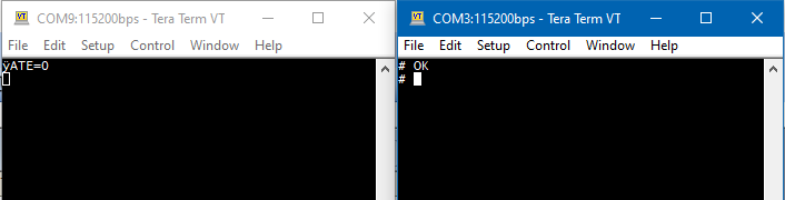

Nucleo-L073RZ board and I-Nucleo-LRWAN1 (USI module) shield - as supplied as the "Sensor" part of the P-NUCLEO-LRWAN2 kit:
The documentation refers to I-CUBE-LRWAN at v1.2.2; in v2.0.0 (March 2021), the directory structure has changed somewhat.
I assume the correct path for the "Sensor" node project is now:
Projects\NUCLEO-L073RZ\Applications\LoRaWAN\LoRaWAN_AT_Master\STM32CubeIDE\I_NUCLEO_LRWAN1
Can anyone confirm if this actually works?
At the moment, mine doesn't seem to be sending any AT commands from the Nucleo board to the USI shield...

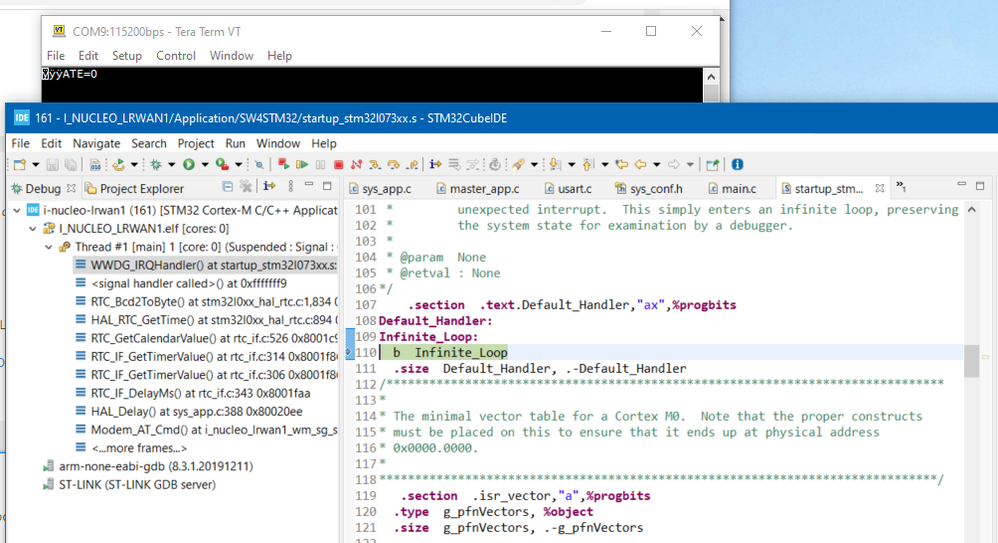

I have now tried this - and it has not helped.
I still see just the ATE=0 command sent, and then the code hangs in the infinite loop.
EDIT
Monitoring both Tx & Rx on the UART:
