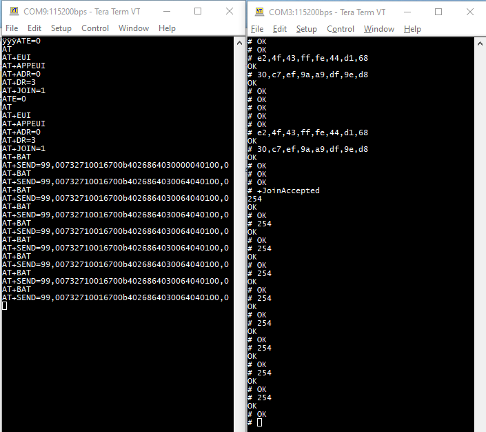

At the moment, mine doesn't seem to be sending any AT commands from the Nucleo board to the USI shield...

OK and sorry for this omission. I did a complete compare between your Project and my project . In the file stm32l0xx_it.c we have to include the header file "sys_conf.h" (see attached file)
Ah - that's better:
0693W00000D0eakQAB.pngnow to see what's happening at the TTN end ...
JCOUP
OK, we see that the join has been accepted... 254 is the response to the battery level request and data has been send to the 99 port.. keep me info on the TTN result

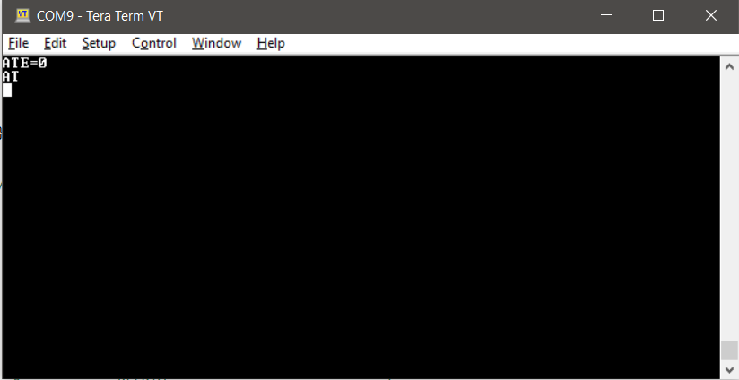

I bought the lrwan2 that came with a gateway and l073Rz as the end node with the p-Nucleo-lrwan1 as the shield. After downloading the software pack "STM32CubeExpandsion-LRWAN2-V2.1.0", I followed the document "getting-started-with-the-lrwan2-starter-pack" named "dm00620948". I tried communicating to the shield using AT-Commands and had no luck. It wouldn't let me type anything on the serial monitor. Note: I had the RX and TX pins on the shield connected to the debugger size.
I then flashed the AT_master provided in STM32CubeExpansion_LRWAN_V2.1.0\Projects\NUCLEO-L073RZ\Applications\LoRaWAN\LoRaWAN_AT_Master and got the following in Capture1. Note: I changed Debugger_ON to 1 in sys_conf.h. Anything that I typed did not respond to me.

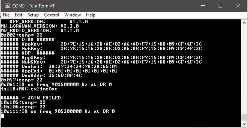

I then tried to flash the END_node located in STM32CubeExpansion_LRWAN_V2.1.0\Projects\NUCLEO-L073RZ\Applications\LoRaWAN\LoRaWAN_End_Node, while making sure I changed the region located in lora_app.h and lorawan_conf.h I also turned debugger ON. Static_device_EUI is set to 0 so I added a device on the TTN that way. The results I got is in Capture20693W00000FBCgpQAH.png
I can't get anything to work and don't know where to start to try and fix this. If there is any other information that I missed please let me know.
