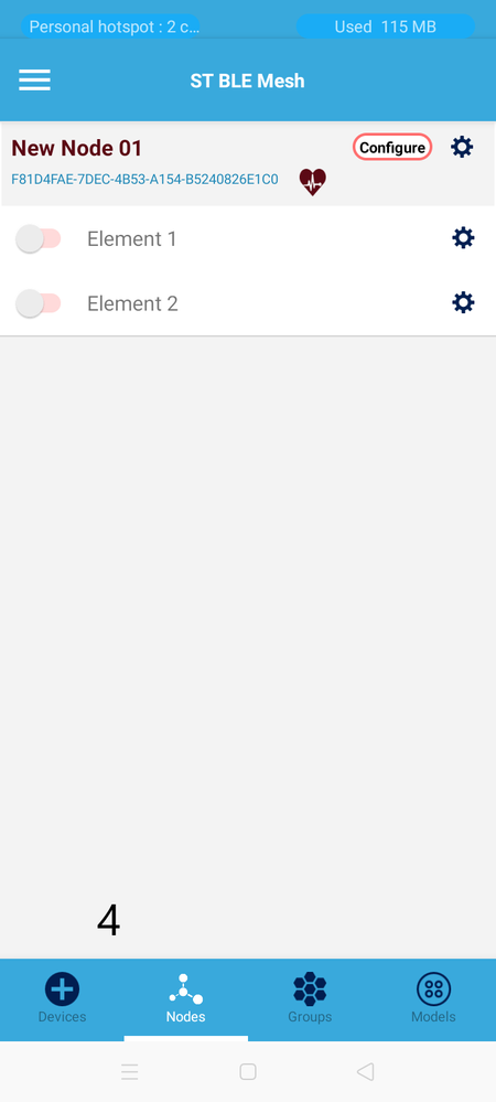

AC.3
hi Remi QUINTIN ,
You recommend me to use the latest cubeWB FW package V1.8, when I use the latest version ST BLE Mesh app always stopping
I used BLE_MeshLightingPRFNode project from cubeWB FW package V1.8, I loaded the code to the board and worked successfully.
Here the node contain only one element by default, I want three elements .
In appli_mesh.c line number 121 is /*Number Of Elements selected per Node. Maximum Elements supported = 3*/
So, I edited APPLICATION_NUMBER_OF_ELEMENTS to 3, I loaded the code and provisioned the node, during the configuration step(adding the publish and subscribe address) in ST BLE Mesh app the app stopped. I reopened the app and the screen is like this (added image), I do not know what happened, what happened to Element 2 and Element 3?
I controlled Element 1(Blue LED on the board) but when I clicking on Element 1 or Element 2 ST BLE Mesh app is stopping always. And I can not assign publish and subscribe address to them, it's failed.
Help me to fix this issue.
I successfully controlled three elements by using cubeWB FW package V1.3 without any problem.
Why cubeWB FW package V1.8 can not run 3 elements?

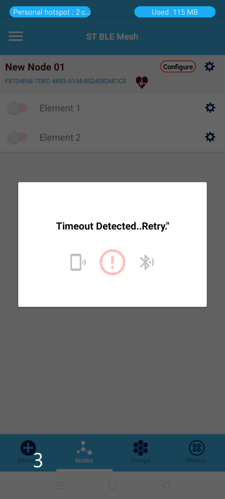

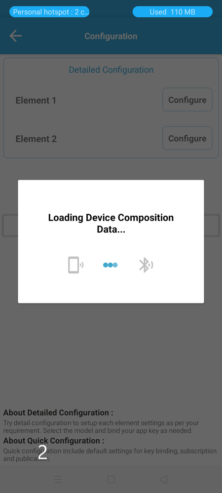

Hello Remi QUINTIN,
I edited the code as you mentioned above, but it doesn't worked. After provisioning the node the BLE Mesh App waited Loading Device Composition Data.... stage. After a lot of time it return to main window without configuring the elements, I tried a lot of times but I can not configure the elements.
Is there any other changes required here in mesh_cfg_usr.h file??

AC.3
Hi EMECH ,
Thanks for your reply.
I set the APPLICATION_NUMBER_OF_ELEMENTS to 3 as you mentioned above, but it doesn't worked. The BLE Mesh App waited in Loading Device Composition Data.... stage After provisioning the node. Mesh App returning to main window without configuring the elements, I tried a lot of times but I can not configure the elements.
Also I want to increment the number of elements per node to 6,please give me a suggestion .
I could not find any document about this.

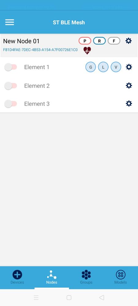

EMECH
​Hi,
With the following configuration:
#define ENABLE_GENERIC_MODEL_SERVER_ONOFF                                 (5) //element 1 + element 3
#define ENABLE_GENERIC_MODEL_SERVER_LEVEL                                   (1)
There is no model on the second element, empty element can be a trouble during provisioning.
If you want to set this kind of configuration, try to set:
#define ENABLE_GENERIC_MODEL_SERVER_ONOFF                                 (3) //element 1 + element 2
With:
#define APPLICATION_NUMBER_OF_ELEMENTS                                        2
But initially I have seen that you want to set the following configuration as you have written:
"I am using 3 elements per node, Element1 I am using to control a light, Element2 for to control a fan and Element3 for to control an AC or a TV.
So I want to run generic onoff server model in Element 1, generic onoff server and generic level server models in Element 2 and generic onoff server model in Element 3.
Is that possible??"
Yes it is possible with the following configuration:
#define ENABLE_GENERIC_MODEL_SERVER_ONOFF                                 (7) //element 1 + element 2 + element 3
#define ENABLE_GENERIC_MODEL_SERVER_LEVEL                                   (2) //element 2
And:
#define APPLICATION_NUMBER_OF_ELEMENTS                                        3
Let me know if the provisioning is OK with the above configurations.
The maximum number of elements with the MESH library binary embedded in the cubeWB FW package V1.8 is 3 with a maximum number of models per element of 20.
It is possible to have more elements with a new MESH library binary.
Best regards.
