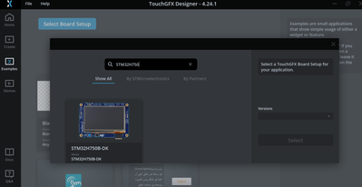

I recommend using TouchGFX  for your own  project. Please download the TouchGFX Designer a tool that helps you design graphics easily and ensures smooth display performance on your board.
You can choose your specific board, such as the STM32H750B-DK, as shown below. Then, customize your graphics and flash them directly to your board.
You can find the TouchGFX package and the X-CUBE-TouchGFX expansion on ST.com.
