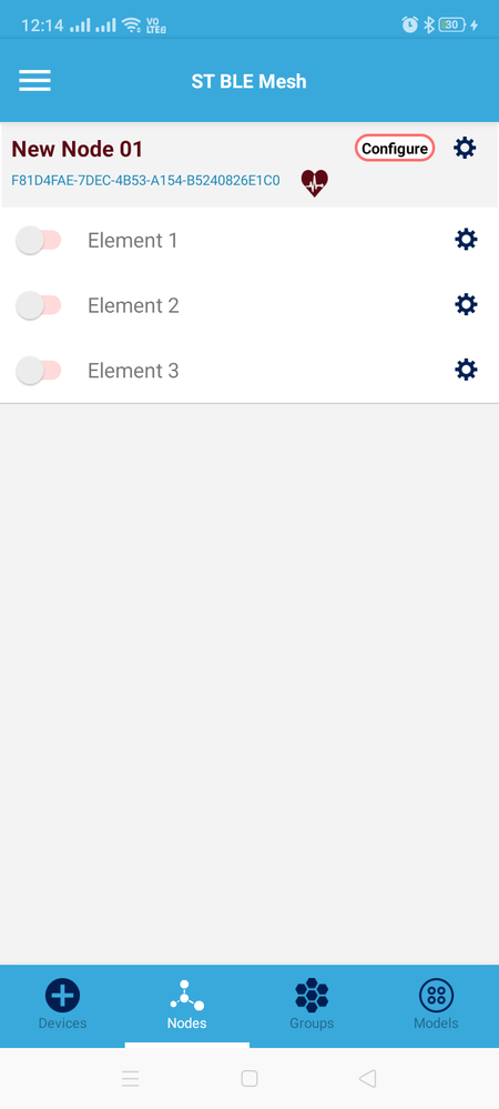

I am using STM32WB55 Nucleo Pack (STM32WB55RGV6 MCU) and STM32Cube_FW_WB_V1.3.0 SDK, I uploaded BLE_MeshLightingDemo code (without any edit) and provisioned the node using ST BLE Mesh app , all the elements in a node shows simillar models.
I want to to run different models on different elements in a single node, help me please....

#define APPLICATION_NUMBER_OF_ELEMENTS 3

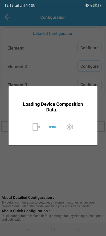

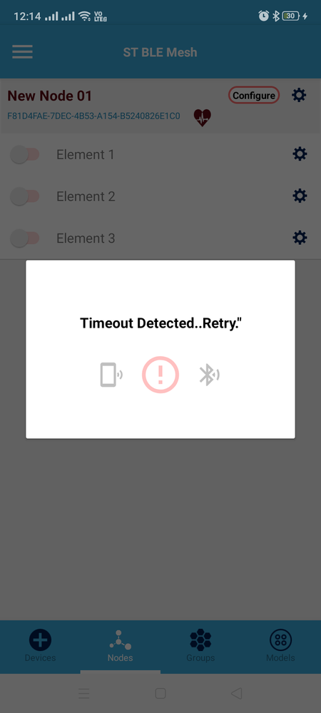

The provisioning completed successfully, but Couldn't configure the node.
The BLE Mesh app trying to get Device Composition Data(Loading Device Composition Data),but it can't.

‎2020-09-25 5:58 AM
​Hi,
OK, the troubles you have with multi element during provisoning with Android ST BLE Mesh App is solved in the next Android ST BLE Mesh App and the STM32Cube_FW_WB_V1.9.0 normally availables at the end of this month.
With the IOS ST BLE Mesh App and the STM32Cube_FW_WB_V1.8.0 you do not have this kind of trouble.
In the meantime, perhaps you can have the opportunity to use the IOS ST BLE Mesh App ?

‎2020-09-27 9:30 PM
Hi EMECH,
We tried IOS ST BLE Mesh App with an Iphone 6s on IOS 14.0 and the STM32Cube_FW_WB_V1.8.0(three elements per node) , but the same problem occurred again. Couldn't configured the node after provisioning.

‎2020-09-28 8:47 PM
Yes, I have the same trouble during Loading Device Composition Data, So configuration failed.
I tried a lot of times, but the result was same.

‎2020-10-02 1:28 AM
​Hi,
Please try with the new STM32Cube_FW_WB_V1.9.0 published on https://www.st.com/en/embedded-software/stm32cubewb.html
This release includes a lot of modifications related to the described troubles.
Do not forget to update the BLE stack, see the how to proceed in STM32Cube_FW_WB_V1.9.0/Projects/STM32WB_Copro_Wireless_Binaries/STM32WB5x/Release_Notes.html.
Best regards.
‎2020-10-04 10:28 PM
Thanks for your help.
It worked successfully with 3 elements per node.
