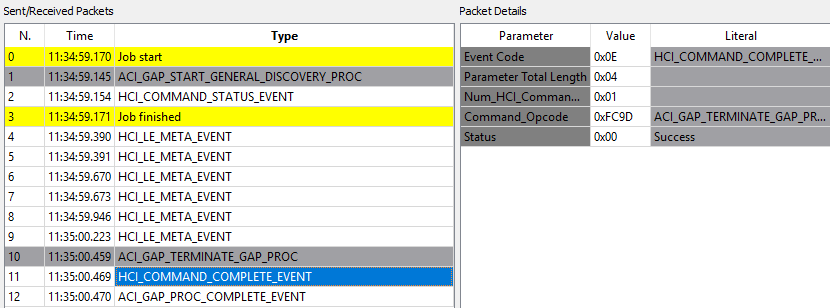

‎2020-11-03 7:38 PM
ACI_GAP_TERMINATE_GAP_PROC shall work.
Attached the screenshot terminating the scanning after 1 second.
‎2020-11-04 1:33 AM
yes @Winfred LU
Open Winfred LU Preview
I fallow the same steps but aci_gap_terminate_pro(0x02) function returns status ERR_NOT_ALLOW.

Please refer to AN5270 - STM32WB Bluetooth® Low Energy (BLE) wireless interface
section 2.4.23 ACI_GAP_START_GENERAL_DISCOVERY_PROC
The procedure is terminated when either the upper layers issue a command to terminate the procedure by issuing the command ACI_GAP_TERMINATE_GAP_PROC with the procedure code set to 0x02 or a timeout happens (the timeout value is fixed at 10.24 s).
Please note that there is different ACI called ACI_GAP_TERMINATE, which is used to terminate the connection. Don't get confused with ACI_GAP_TERMINATE_GAP_PROC .
