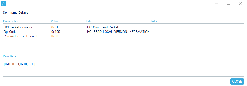

@stephane.legargeant​ I checked the manual, but the problems described either do not refer to mine or the solutions do not help. After using the given binary and connecting the board to the PC with USER USB, no COM port appears. Through the ST-LINK USB the port cannot be opened again. I am using Windows 10. The logs look like this.

First, you must use the ST-LINK USB connector to connect the Nucleo board. The USER USB is not used in transparent mode on Nucleo.
Can you check if the error is "Device under test not responding" or "Could not open COM port" ? (The first one indicates that port was found and opened, but there was no answer from board. The second indicates that port can not be opened.)
‎2020-07-10 05:12 AM
@stephane.legargeant​ Using the ST-LINK USB the error says "Device under test not responding" in BLE and OpenThread mode but "Could not open COM port" in RF mode.
