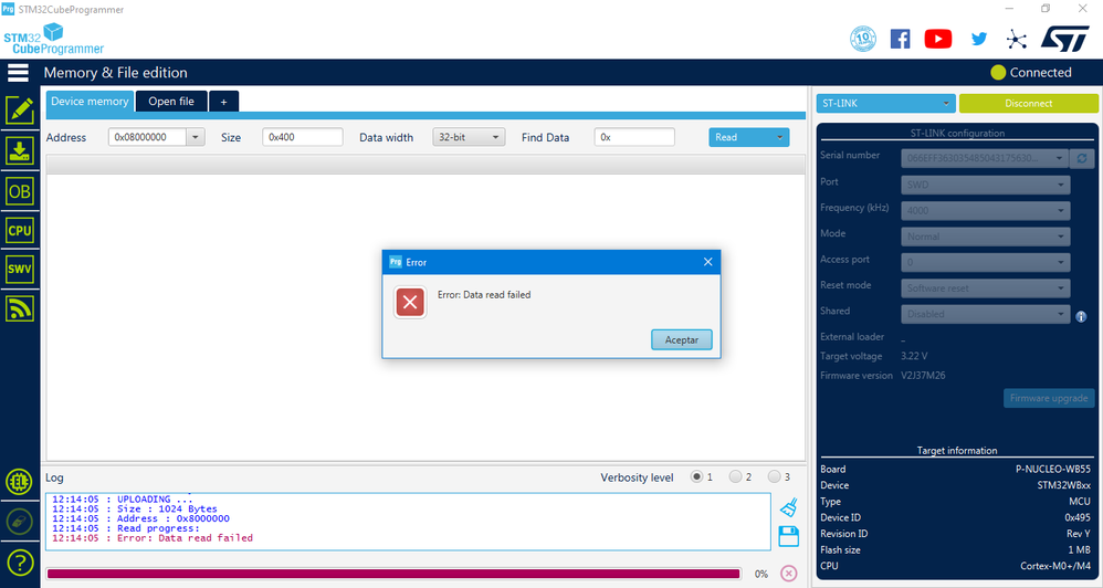

  3. I desconnected and connected again the Nucleo68 USB cable but when I read its data a message apears with "Error: Data read failed".
I can't read any page of the flash:
0693W000007BL8uQAG.pngI guess that I can erase flash because apears the following message when I erase a sector:

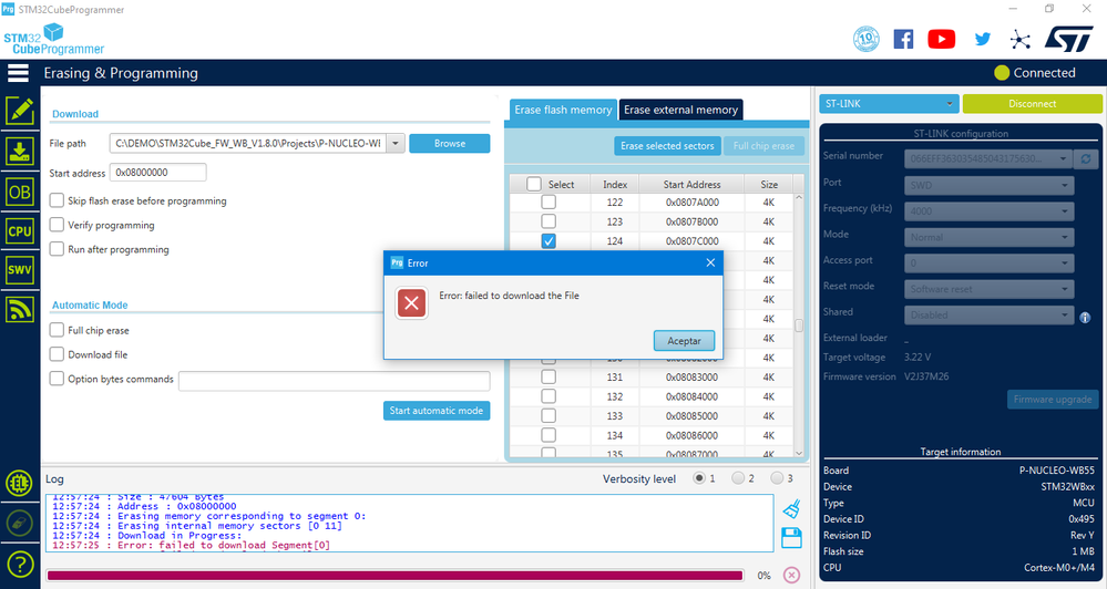

0693W000007BL8kQAG.pngBut when I download a file this failed:

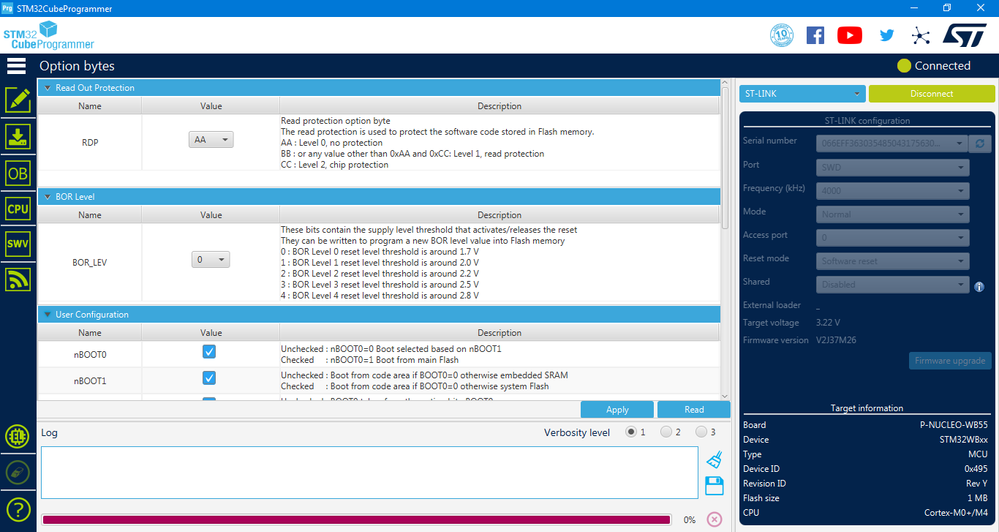

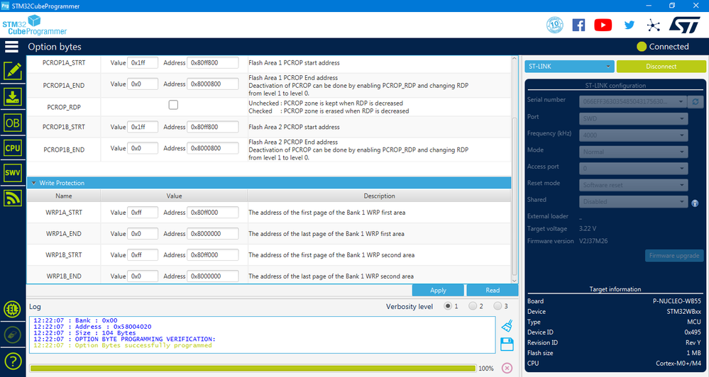

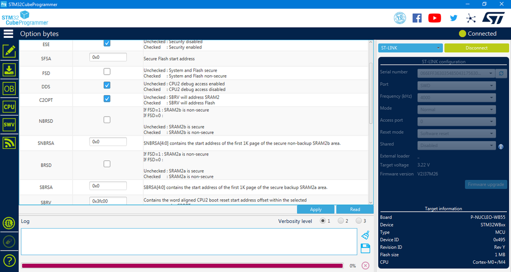

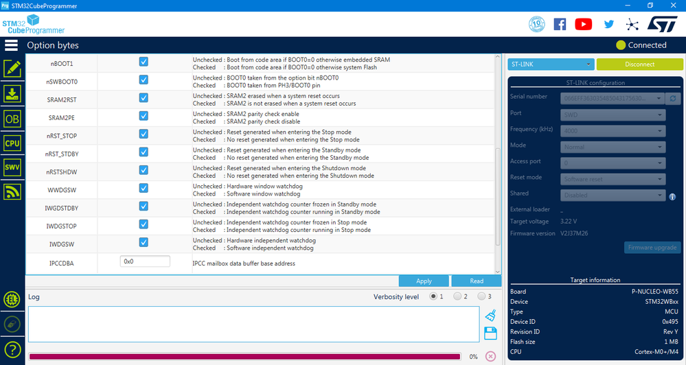

0693W000007BL9TQAW.pngChecking the RM0434 Reference manual the option bytes are ok because are in ST production value, here the option bytes of my STM32WB55 on Nucleo68 board:
0693W000007BLAbQAO.png0693W000007BLAlQAO.png0693W000007BLAqQAO.png0693W000007BLBFQA4.pngI changed the USB cable, put the BOOT0 pin to VDD(3.3V), put the BOOT0 pin to GND and always apears "Error: Data read failed".
