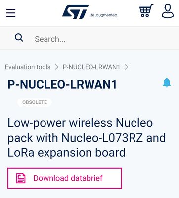

The end node may have some problems. My suggestions is to try to migrate to the STM32WL Nucleo board since the product you are using as end node is already classified as obsolete :
Best Regards.
STTwo-32
2024-02-24 8:03 AM
That's P-NUCLEO-LRWAN1
OP said P-NUCLEO-LRWAN3 - which is marked as 'Active':
:thinking_face:
2024-02-24 8:29 AM
Sorry for this mistake @Andrew Neil @Dan33.
This package still Active but i suggest you to try connecting another node to the same Gateway or connect this end node to another Gateway. So we can understand the source of the problem.
