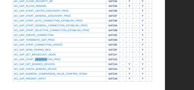

I generally use :aci_gap_start_general_discovery_proc_cp0 , works fine, but it only shows connectable devices .
Now , I am trying : aci_gap_start_observation_proc_cp0 - doesn't work for me
But it causes an issue, return 0x0C on stack 1.21.
I simply replaced the aci_gap_start_general_discovery_proc_cp0  with aci_gap_start_observation_proc_cp0
stack_full

I had to add 2 new params, made them 0.
STTwo-32
Hello @DS.4
Will using the ACI_GAP_START_OBSERVATION_PROC, CENTRAL_ROLE and OBSERVER_ROLE have to be set at initialization.
Best Regards.

sounds about right , thanks
