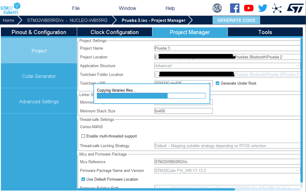

Im' following this tutorial of STM32WB55: https://www.youtube.com/watch?v=CKYWy7LKL68&list=PLnMKNibPkDnG9JRe2fbOOpVpWY7E4WbJ-&index=19&ab_channel=STMicroelectronics
All is fine until I try to generate code. It gets stuck at the moment of "Copying libraries files...".

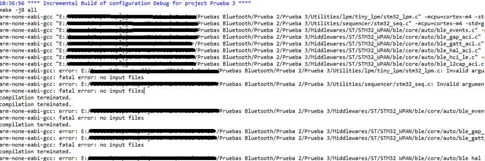

0693W00000Lw9YWQAZ.pngWhat I have tried is not to generate code Under Root. But the problem after doing this is that I can't compile the project. And returns to me 9 errors, all of them sayng that one of the files has "Invalid arguments".
0693W00000Lw9WaQAJ.pngIs this a problem of CubeMX? I have tried it with the same versions that the tutorial use:

Best answer by TDK
Perhaps try using a directory without spaces or non-ascii characters.
4 replies
TDKBest answer
March 29, 2022
PGarg.1
PGarg.1Author
March 29, 2022
Thanks TKD!!! I've been many days with this and you solutionated it in two seconds. I put the project in this directory and worked: E:\Prueba_BLE
