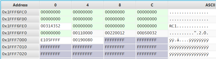

Good day,
On a brand new SMT32WB5MMG MCU, I have found that the One-Time Programmable area is not empty. See the image. The OTP area starts at 0x1FFF7000. There is also some data right before the OTP area - what is that doing there as well?0693W00000LvZmrQAF.pngFor context, I'm using the STM32WB5MMG in a custom application (i.e. not a NUCLEO board). I have seen the same issue (and the exact same data) on two different boards.
I did not encounter this issue when using an STM32WB55RGV6 previously.
Has anyone else encountered this?

For parts from the WB family, we write in OTP area the following information:
  • Module ID
  • HSETUNE trimming information
Address: 0x1FFF7000h / Data: 0xFFh (assuming 0xFFFF for module board identifier)
Address: 0x1FFF7001h / Data: 0xFFh
Address: 0x1FFF7002h / Data: 0x05h device ID
Address: 0x1FFF7003h / Data: 0xE1h Company ID
Address: 0x1FFF7004h / Data: 0x80h Company ID
Address: 0x1FFF7005h / Data: 0x00h Company ID
Address: 0x1FFF7006h / Data: 0x19h trimmed HSETUNE[0:5]
Address: 0x1FFF7007h / Data: 0x00h index
HSE trimming is normally done by user once the Crystal is mounted. For Modules (where Crystal is embedded) we were asked to do this trimming at final test (FT) and store it in the OTP.
Hope that clarifies.

The 28KB bank ahead of the OTP area is the system memory starting from 0x1FFF0000 to 0x1FFF6FFF.
The system memory holds the boot code from which the CPU1 boots in system memory boot mode.
The area is reserved and contains the boot loader used to reprogram the Flash
memory through one of the following interfaces: USB, USART1, I2C1. It is programmed
by STMicroelectronics when the device is manufactured, and protected against
spurious write/erase operations. For further details, refer to the AN2606 available
from www.st.com.

Remi QUINTIN
I got your details. both markings of those modules are the same which is not surprising.
Regarding the values already present at the start of the OTP area, this could come from some HSE clock trimming operations done at manufacturing level. The UID (Universal ID that helps identify the type of device) is also located somewhere in the OTP Area.
I need to check the map of those values to understand if they can match with your extract.
Note that anyhow, it is not a bug and this situation should not create any issue for your development.

Indeed we should add this info in the datasheet.
Note that this 1 Kbyte (128 double words) OTP (one-time programmable) area is for user data and only two double words are used out of manufacturing.

It does, however, affect my implementation somewhat. I make use of the OTP area to store the product's serial number. But STM now assumes a defined structure for data in the OTP area, as given in the CubeMX generated otp.h and otp.c (see the OTP_ID0_t struct). A given serial number may be misinterpreted as the id field, and thereby the wrong HSETUNE values will be read!
@Remi QUINTIN​, would you be able to please file a request with the folks writing the HAL libraries to at least add user sections to the otp.c and .h files, so that a custom implementation can be done? And at best, add some more flexibility as to how the OTP area is used.

If think there is a misunderstanding there.
The OTP_ID0_t struct is only for the first part of the OTP area. The retrieval of the BdAddress in app_ble.c file or the reading of the HSE trimming value in main.c file are the only functions using this structure.
Then all the remaining OTP area is for your own usage to store value you want to save.
Once written, you get an id for the position of the OTP DWORD that your value is written at.
You just have to use the same id to reprieve your value.
Thee fact that the start of this OTP area is used for ST usage should have no impact on your application. The OTP_ID0_t structure is really meaning less for your own storage of value.
