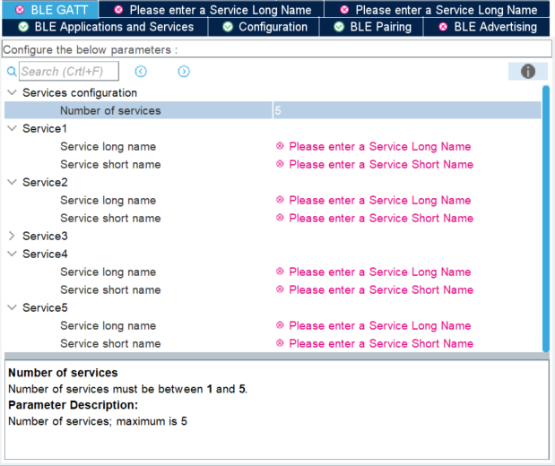

When configuring BLE using STM32CubeIDE Device Configuration Tool with a custom template I can only set up to 5 services and 5 characteristics per service. What is the reason for that?
Is there a possibility to set more services and characteristics per service?

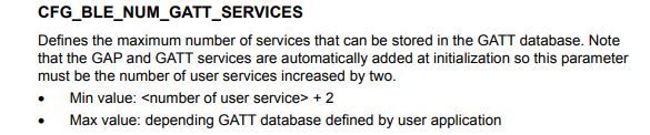

The maximum number of service depending GATT database defined.
So for BLE GATT configuration, define the number of services you need : CFG_BLE_NUM_GATT_SERVICES , and you must add 2 regarding additional mandatory services used by the application (This parameter should be 2 plus the number of user services).
This is descrbed in the AN5289 Application note Building wireless applications with STM32WB Series microcontrollers

Even if i change CFG_BLE_NUM_GATT_SERVICES to 10 the configuration tool doesn't allow me to put a higher number than 5 for the "number of services".

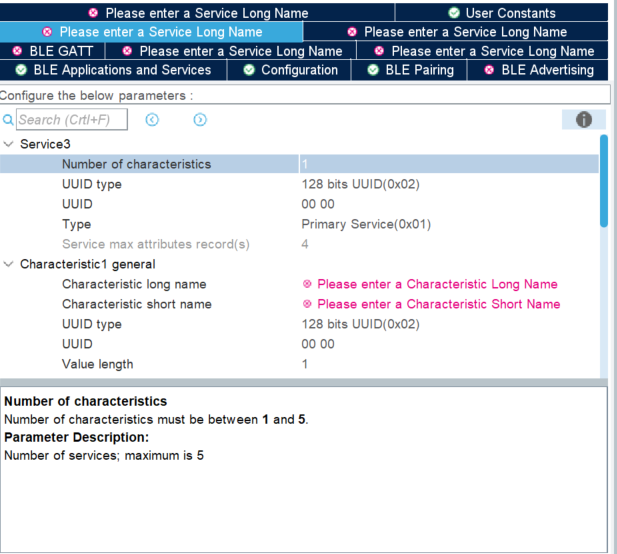

I guess it could be a bug of the tool as in the information box of "Number of characteristics", that seems to depend on that maximum number of services, too.
"Parameter of services; maximum is 5"

To see if the maximum number of services is a limitation of cubeMX, I add manually other services and increased CFG_BLE_NUM_GATT_SERVICES constant to 10, but after 5 call of aci_gatt_add_service() with differents defined services, the 6st call fail with a return code 0x48 (BLE_STATUS_OUT_OF_MEMORY).
I also added manually more than 5 characteritics for one service with aci_gatt_add_char() function, but I didn't reach a limitation in that case.
So is there a limitation in the BLE stack about the number of primary services ? Is it possible to share more memory to increase the number of services ?

Was there any further development on this topic. I too have the problem of services and characteristics both limited to 5 each.
I was able to manually add a 6th characteristic but the changes I had to make were to non-user-editable code and would therefore be a pain to recreate after every code generation for changes to the .ioc file.

i also struggle here with the maximum number of characteristics possible.
is there any new information?
