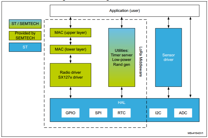

Is there actually any documentation anywhere of the code structure ... ?
‎2018-01-03 3:53 AM
Please refer to
http://www.st.com/resource/en/user_manual/dm00300436.pdf
and mainly ''Architecture'' paragraph where you find this figure:-Amel
