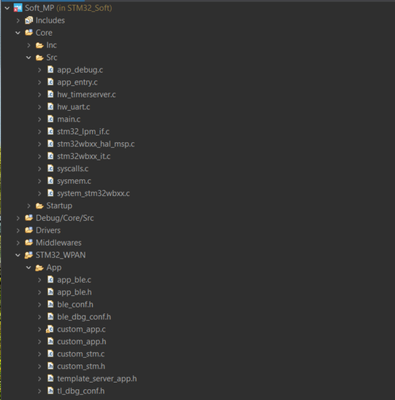

Hi everyone,
I'm trying to add a new file Alarm.c to my project. I added it in the Core>Src folder but I want to use it in a custom_app.c file that is located in another folder (STM32_WPAN>APP) as I use BLE. I included it to this file but when I compile, it doesn't find it in this file. How can I do to declare Alarm.c in one location and all my project's folder can find it?
Thank you

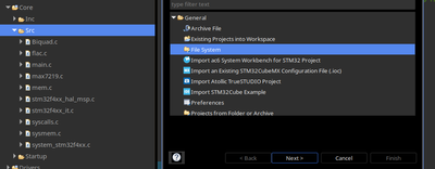

How - just copy in ?
To let the IDE know, some (.c or .h) file now part of your project, you have to use : import.
So right click on the folder you want it to be, -> import -> from file sytem -> next ...

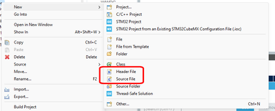

Thank you for your answer. I simply created a new .c file in the Core>Src folder. I am new to STM32CubeIDE and C programmation. I would like to create a .c file with different functions in it that are used in main.c and custom_app.c files. How can I do this ?
Almost same: right click on the folder you want it to be, -> new -> Source file
+ give name (no spaces, no special characters) , like : my_new.c
Thats it.

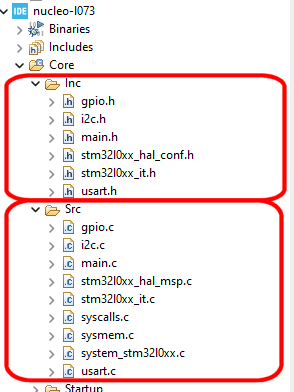

You will also need to create a .h "header" file - use the same approach:
The header file contains extern declarations of the things you want to be shared with other source files.
To use it, those other source files will need to #include the header.
https://c-faq.com/decl/decldef.html
To be sure that the compiler will be able to find the header, it must be in a folder that's included in the Include Paths.
The auto-generated ST code tends to have separate folders for source (Src) and header (Inc) files; eg,
This is a matter of style that you may or may not wish to follow...
