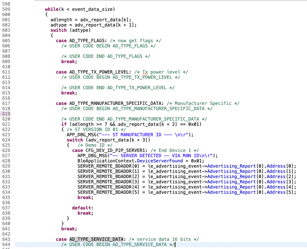

I'm having a little trouble following along with this, where in the code (say the P2pClient code) would I be able to find this section to add the case statement? I assume this case statement you're suggesting to add will parse the advertising packet to confirm if it's the specified UUID we're looking to connect to?

In app_ble.c file, see SVCCTL_App_Notification function:
case HCI_LE_ADVERTISING_REPORT_SUBEVT_CODE:
  uint8_t *adv_report_data;
  /* USER CODE BEGIN EVT_LE_ADVERTISING_REPORT */
  /* USER CODE END EVT_LE_ADVERTISING_REPORT */
  le_advertising_event = (hci_le_advertising_report_event_rp0 *) meta_evt->data;
  event_type = le_advertising_event->Advertising_Report[0].Event_Type;
  event_data_size = le_advertising_event->Advertising_Report[0].Length_Data;
  /* WARNING: be careful when decoding advertising report as its raw format cannot be mapped on a C structure.The data and RSSI values could not be directly decoded from the RAM using the data and RSSI field from hci_le_advertising_report_event_rp0 structure.              Instead they must be read by using offsets (please refer to BLE specification). RSSI = (int8_t)*(uint8_t*) (adv_report_data + le_advertising_event->Advertising_Report[0].Length_Data);
  adv_report_data = (uint8_t*)(&le_advertising_event->Advertising_Report[0].Length_Data) + 1;
  k = 0;
  /* search AD TYPE 0x09 (Complete Local Name) */
  /* search AD Type 0x02 (16 bits UUIDS) */
  if (event_type == ADV_IND)
    /* ISOLATION OF BD ADDRESS AND LOCAL NAME */
    while(k < event_data_size)
      adlength = adv_report_data[k];
      adtype = adv_report_data[k + 1];
      switch (adtype)
        case AD_TYPE_FLAGS: /* now get flags */
         /* USER CODE BEGIN AD_TYPE_FLAGS */
         /* USER CODE END AD_TYPE_FLAGS */
         break;
        // ADD HERE THE CASE THE MANAGE AD TYPE FOR UUID
    } /* end switch adtype */
    k += adlength + 1;
   } /* end while */
  } /* end if ADV_IND */
break;

_legacyfs_online_stmicro_images_0693W00000bizMiQAI.pngHow would I amend the code to work with my device as the issue I'm coming across is it appears it's currently developed specifically for an ST device? I'm trying to develop a second case statement for a "device 2" which would (ideally) connect the client Nucleo board to my Foot Tracking Sensor.

I want to know this, too. I captured my custom board (Gatt Server) advertisement inside the case statement. by modifying to this line.
else if(adlength >= 4 && adv_report_data[k + 2] == 0x12){
switch (adv_report_data[k + 3])
My problem now is I can't read the data sent by my custom board (Gatt Server) to the client board (Gatt Client) which is the nucleo. Is there I had missed where I can input the Service UUID?
