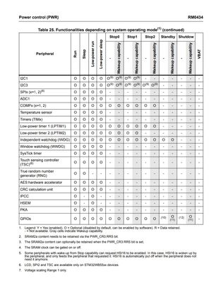

Is it possible to use the ADC polling/DMA/IT in STOP2 mode. The application is to develop a low power platform for ADC sampling and go back to sleep. After a certain period send this data over BLE.

As you can see on the table table 25 of the RM0434, the ADC can work only in RUN, SLEEP, Low Power run and Low Power Sleep modes:

Hi @STTwo-32
Thanks for sharing the table. I have couple more questions
1. Any necessary steps to be taken to put ADC block in low power mode
2. After waking up from STOP2 mode, any re-initialization of ADC to be done so that ADC can be used in RUN mode?

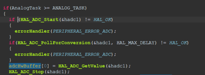

I went through the example. But I was not able to see the IOC configuration and the driver files. Instead of the approach given in the example, I used ADC Polling method
In this approach I'm getting HAL_ERROR in the HAL_ADC_PollForConversion
‎2024-08-21 12:58 AM
The example is not based on the CubeMX. So, there is not a .ioc file for this project. For the Error, this is not on the same context of this post. I suggest you create a new post (after selecting a best answer for this one) on the Embedded Software forum. You should find there the help you need.
